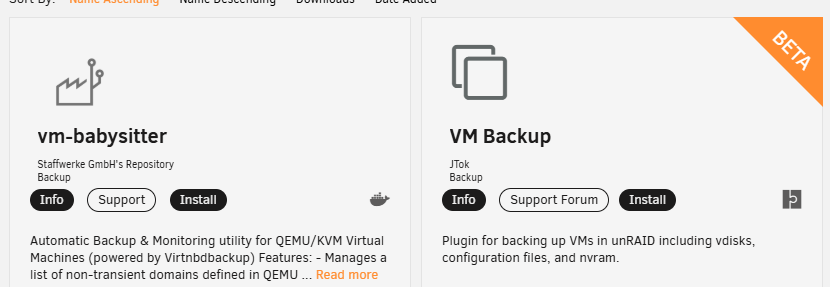

It appears your having issues with the beta plugin vm backup...

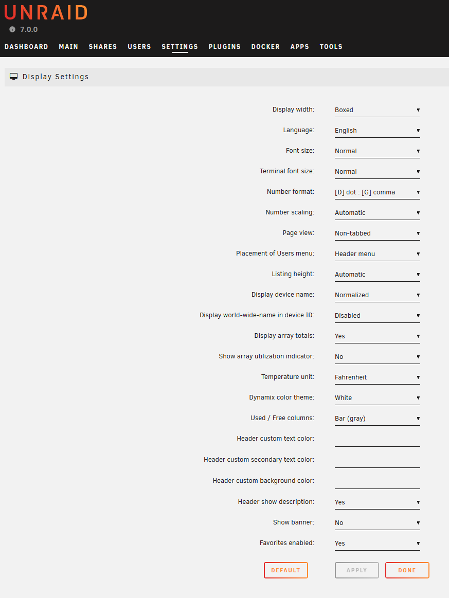

I Don't noarmaly mess with the themes within Unraid? did you do a theme change?
Web UI > Setting > Display Settings

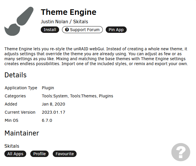

https://docs.theme-park.dev/themes/unraid/
Unless there are remnants of this plugin. I"m not sure why you would be receiving a error that a plugins index page is missing.

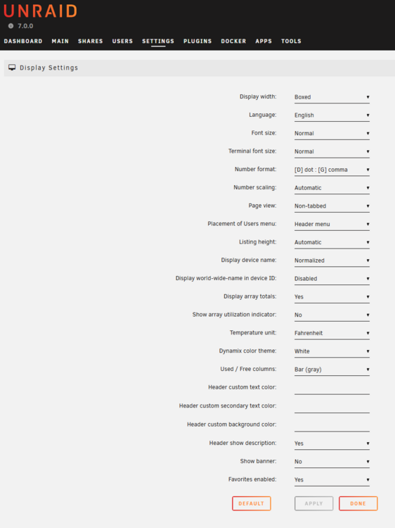

My theme was black for the longest time and recently changed it to white because of the text/icon display issue.

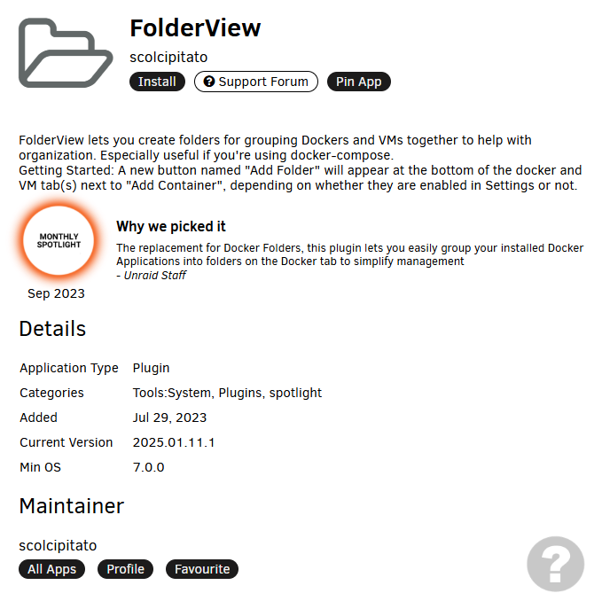

Actually, now that I think about it, is it complaining because the FolderView plugin is not compatible with 6.x?
I have used folder view but left when it broke website and some docer behaviors with auto start.
*Note the min os. It was recenlty updated. but the mainter claims to have left.
Not sure if there is comunity or other mainting it...
AHving tested this in beta 7, It did work outsdie of some spacing isseus... There have been other known issues with the folder view plugin and how the web page is displayed with version 7. this could be that error...
Folder view could be causing theses issues. But no folder view is able to run on unriad v7.

I got the text and icons back!
I had to change the Header custom text color to white (ffffff) in Display Settings.
