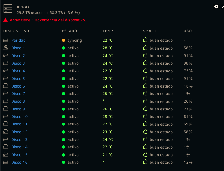

It was that, I change the power supply and the parity disk works correctly, even I added un disk that before gives me errors
