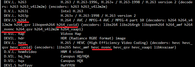

About the issue: the FFmpeg build inside the aforementioned shinobi docker version does not have ANY hardware acceleration for our nvidia gpus (you'll can check with the command "ffmpeg -codecs" inside your docker console).

Now, with that out of the way, you can check with the command ffmpeg -codecs if it worked. Mine is reported as:
And, like that, it'll work as it should.
