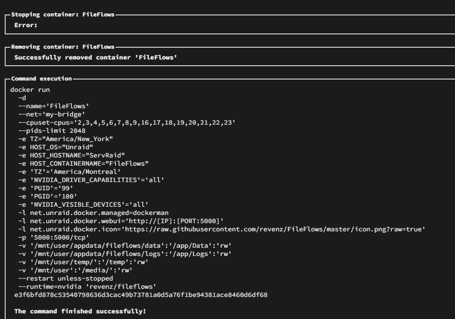

February 20, 20251 yr Hello, I have this problem since a long time. Most docker I have, when I press stop or restart, it timeout with an error on the gui saying an unexpected error appeared. The docker do stop. If I use docker cli, the docker stop nearly instantly. I have the same docker with same configuration on another server and they stop/restart without a problem so I know it's not the docker image. I get this problem even with new docker. The problem also appear when updating, it timeout while trying to close the docker before replacing it. I tried recreating the docker environnement, I even moved to directory instead of docker image and still the same problem. Thank you

February 20, 20251 yr Author Here's the diagnostic. I just reproduce the problem with fileflow container. That's what I get on the gui servraid-diagnostics-20250220-1102.zip
February 20, 20251 yr Community Expert 5 minutes ago, Nodiaque said: fileflow container post docker run
