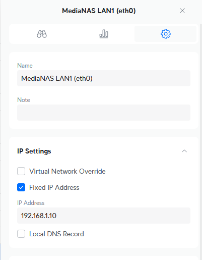

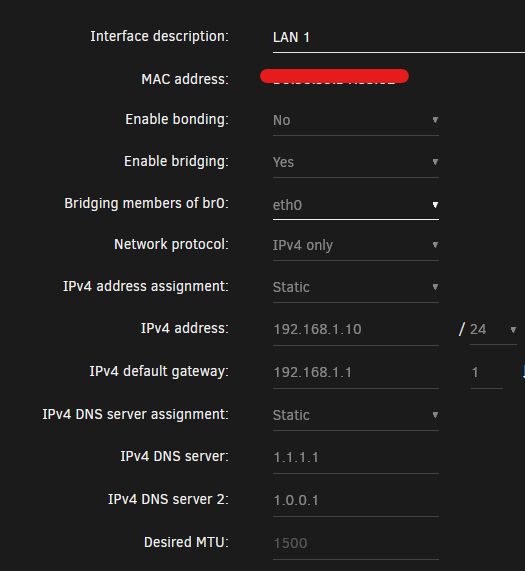

There is nothing inherently wrong with Unraid 7.0.0 networking and UniFi routers/gateways in combination.   I have a UniFi Cloud Gateway Ultra at two different locations managing three different Unraid servers which are all running version 7.0.0 since it came out.  I have zero issues with IP address and login in or navigating the Unraid GUI in any of the three servers.  I can also hit the IPMI/BMC or PiKVM address on each one of them for remote management.
I set a static IP address in both Unraid network settings for the server and in UniFi client settings.  This is overkill, but I want to make sure I am dealing with a known IP address for Unraid servers.  I have also used them all successfully with DHCP.  I can also hit the IPMI/BMC or PiKVM NICs for remote or out-of-band management.
Obviously, this is no help to you in resolving your issue, but it is not a general problem with incompatibilities.  Are you perhaps experiencing IP address conflicts with multiple clients somehow getting the same IP address assignment?
