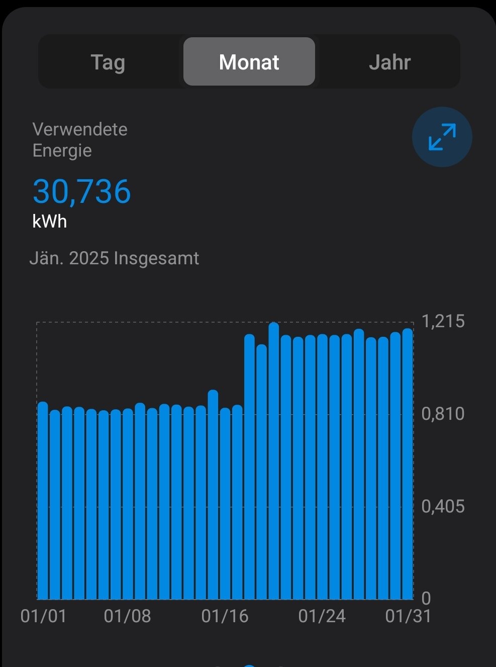

I upgraded to Unraid 7.0.0. between 17th January 2025 and 18th January 2025.
Today I have seen, that my server now needs about 35% more power.
There was no change of the hardware and no additional software.

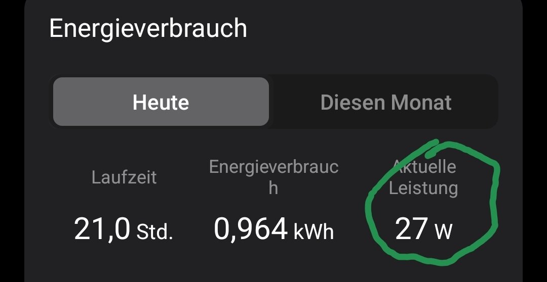

I downgraded to Unraid 6.12.14 and my server needs now again less power. It was about 45 to 50 watts with Unraid 7.0.0.

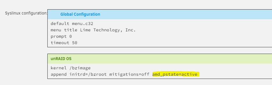

Before doing that, I would recommend trying the various pstate driver options, to see if you can find one that has similar power usage and performance, since technically, pstate should be a better option for AMD CPUs.
I believe there are 3 options:
amd_pstate=passive
amd_pstate=guided
amd_pstate=active
You add one of them to syslinux.cfg, after /bzoot, e.g::
