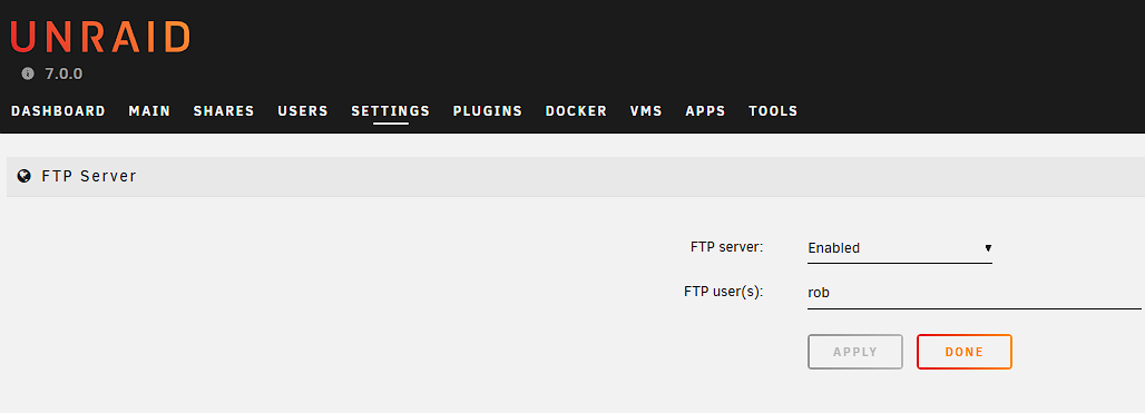

I've got the Sony camera setup with LAN connectivity.  I've enabled FTP on Unraid 7.0.0
But now what?  I verified connections, but the folders available all say permission denied (disk 1, disk 2, user, cache, etc.).  I don't see anywhere where I can define access to a share?

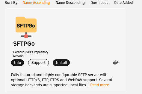

Any suggestions, I tried sFTPGo but nothing happened?

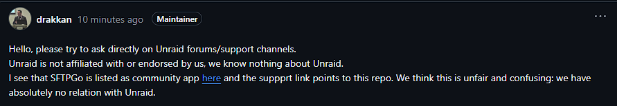

UPDATE: the developer for sFTPGo got back to me and indicated sFTPGo should NOT be listed for apps to use with Unraid?
I think i means that the support link should be pointed to the unraid forums instead. Not that it should NOT be listed for apps. And I agree. @CorneliousJD should have created his own support thread for this container. The docker container itself are drakkan's official image which can be used by anyone on any platform that supports docker. @CorneliousJD just created the template for unraid so we unraid users can get to easily from community apps. All apps on dockerhub can be used on unraid, but for it to show up in community apps someone must create an unraid template for it.
If there is issues with the SFTPGo app itself (like a bug) the right place to ask is on drakkans support channels. But unraid users should ask for support on unraid support channels (this forum). Like for issues with setting up the app or other things than bugs. I guess @CorneliousJD will see this now (since I pinged him 3 times..) if he still is on this forum. So maybe we can get him to create his own thread for this container. Or at least link to the documentation for the app.  It's unfair that we push all the support on drakkan when the app is listed under community apps. So I totally agree with drakkan. If you publish an unraid template you should support it as well. There's probably more then a few unraid users that use the app and would be able to help with support here on the forums.

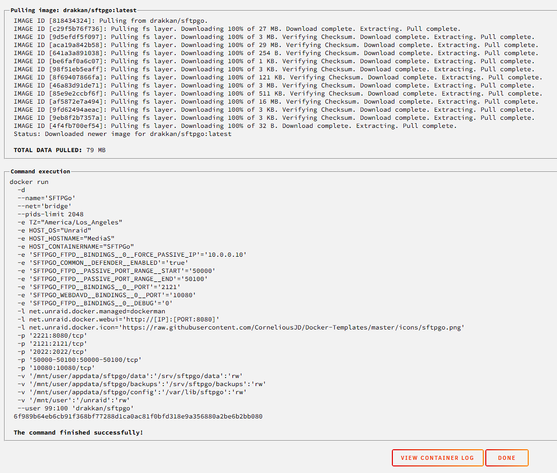

Thanks for the response.  I installed sFTPGo and left the defaults "as is" and hit Apply.  I guess I expected to see a WebUI for it or something, but I don't see anything as if it never installed?
EDIT: I'm looking for the quickest and most simple FTP or SFTP for local network usage exclusively (not public) for my Camera FTP xfer of files to sFTPGo.
Edited by RobAinscough

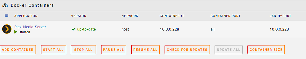

It's not listed in your docker tab? Did you get a an error when installing it?
Correct, not listed in my Docker tab, only have my Plex Media Server

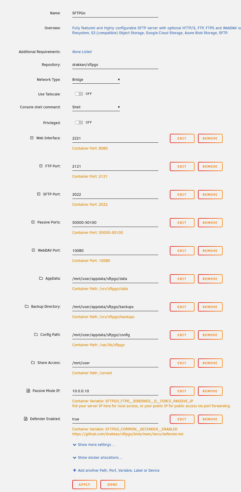

Click Install and get parameters, I don't change any.
Click Apply

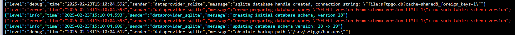

... oh, this time I got a command execution window ... hmmm
And some errors reported:

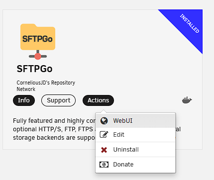

But it does now show up in Installed Apps
Ok, seem to be getting somewhere now.   Will move forward ... but do have a question, how can I make the FTP server local ONLY (no public access)?

By default all apps have no public access unless you open ports for them in your router or use reverse proxy or something. If you want public access it would be best to use tailscale or another VPN service. Or you can also use the very good security features in SFTPGo itself., but then it's a must to set up ssh keys and use SFTP.  You can set up whitelist/black list so only certain IP can log in. Autoblock after x failed login attempts etc.
But if you only want LAN access you're good to go from the start no need to configure anything. Just use your favorite (S)FTP client of choice and connect to the IP. As you see in the template FTP uses port 2121 and SFTP 2022.

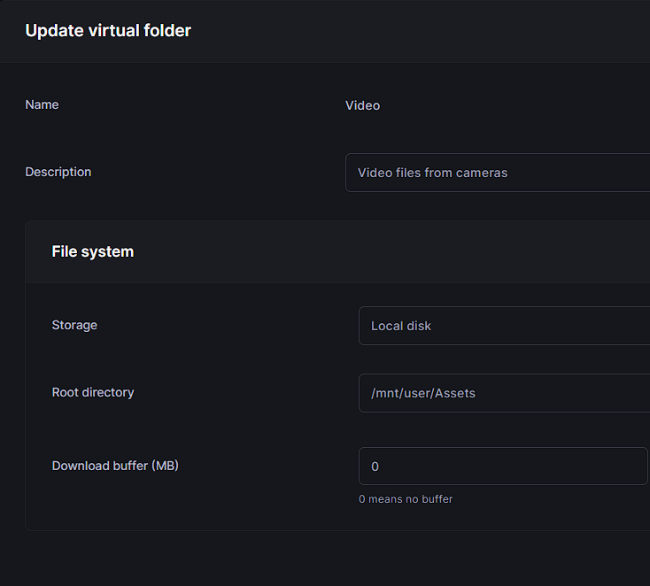

I've created a Virtual Folder
for Root directory I guessed ... "Assets" is one of my shares, but no idea if this is correct?
hmmm ... keep getting permission denied ...

You should also go to the template enable advanced view top right and add this to extra parameters:
--user 99:100
To run it as the correct unraid user. Or else you probably will have permission errors later on.

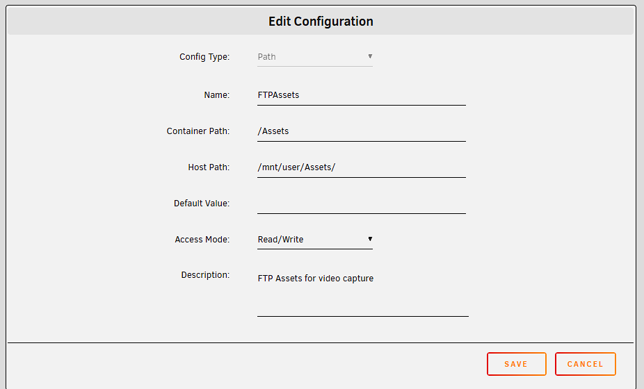

Another question ... how do set a Virtual Folder to point to an existing Share?
It was explained in mye link in my earlier post. You need to map It in your template then use the container path in sftpgo.
f you edit the container then "Add another Path, Port, Variable, Label or Device"
I added the directory NAME (could be anything).
Set the Container path (In my case it was "/Cameras" for my security camera FTP storage location which is /mnt/user/Cameras)
Set the Host Path: /mnt/user/Cameras
Access Mode: Read/Write (obviously)
Then after applying the changes I restart the app. Open the webui for admin.

So in this example the host path: /mnt/user/Cameras is mapped to /Cameras in sftpgo
Hmmm ok, I actually used a new VideoRAW path and followed per your linked info which ... and a share is created called VideoRAW.  I need to edit the share settings under SMB and select "Export = Yes" and now I see the share one my Windows PC file explorer (all good on FTP client side)

Hmmm ... getting 550 error when I try to access an existing share "Assets" from FTP client, shows the folder but can't open it.  Guessing something to do with my path settings but all seems correct?
I added a separate user "sony" and provided read/write access to the "Assets" share and I login to FTP via user "sony" ... but made no difference.   hmmm ...
Nevermind, solved it ... I had entered the Container Path wrong for the existing share.
