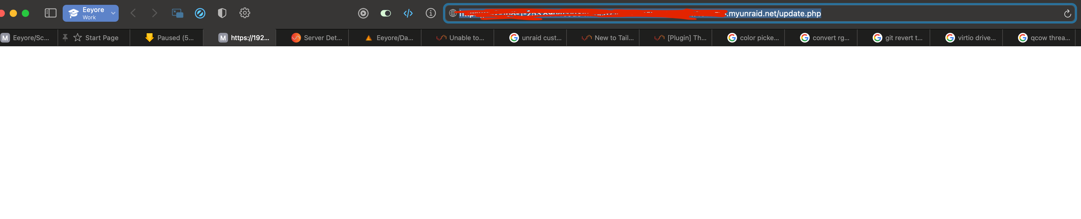

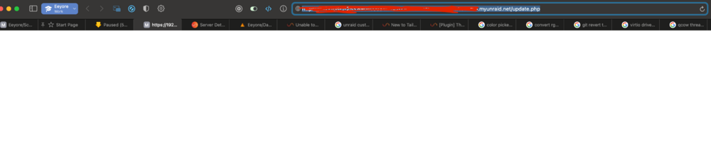

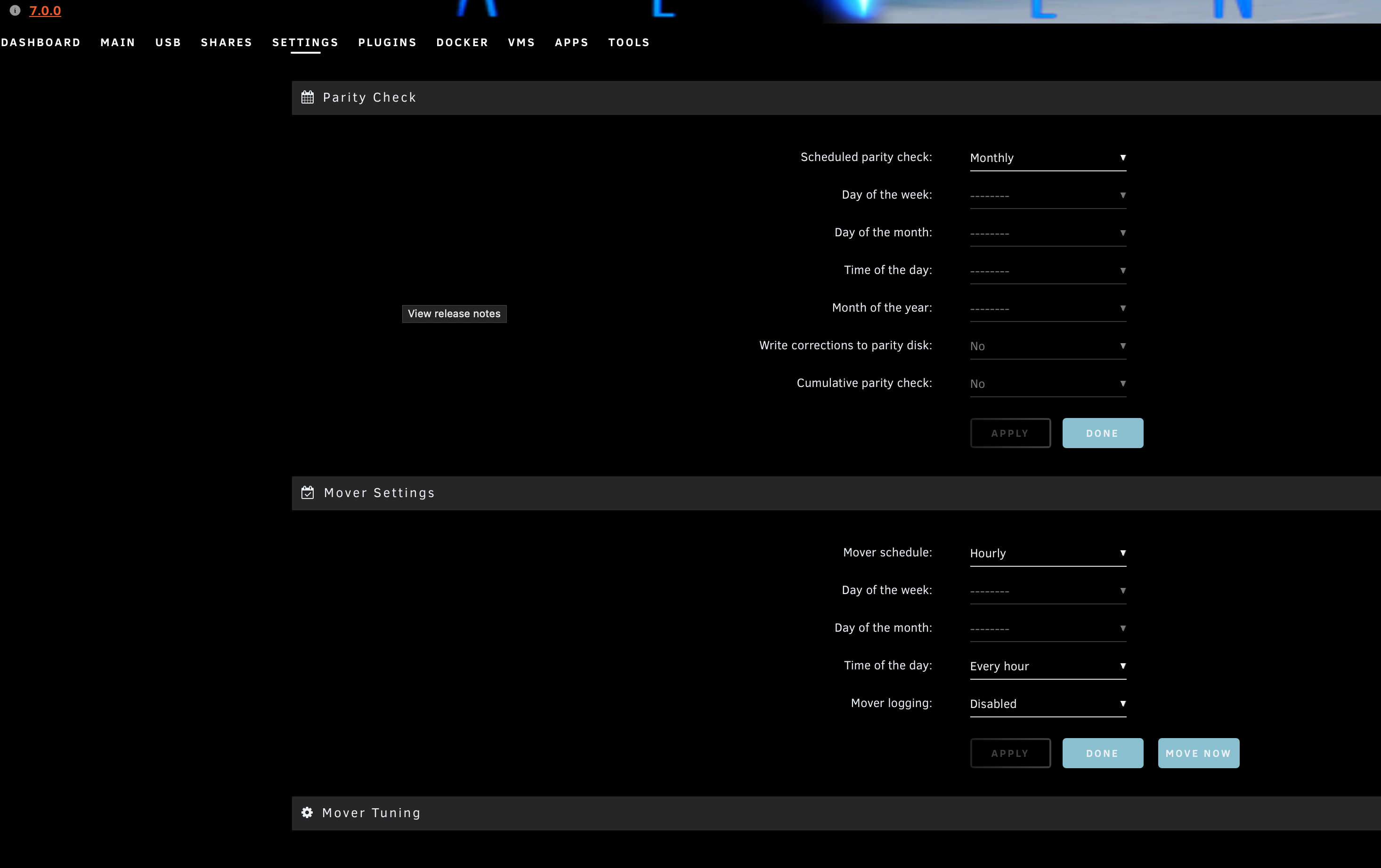

Ok, rebooted - problem persists. Removed Parity Check Tuner plugin - problem persists. Currently,  there is no scheduled parity check, I select Monthly (it is on Disabled). As soon as I select Monthly it pops open the blank tab (see screenshot), and generates the missing csrf_token error. So confused!

Did you boot in safe mode as mentioned? If yes, try using a different browser or even a different device, like a phone or tabled, still in safe mode.
It could also be worth clearing the browser cache to see if that helps.
@JorgeB Much appreciated. I clearly missed the Same Mode part of the reply the first time. That solved the problem.
That suggests plugin is the issue.
