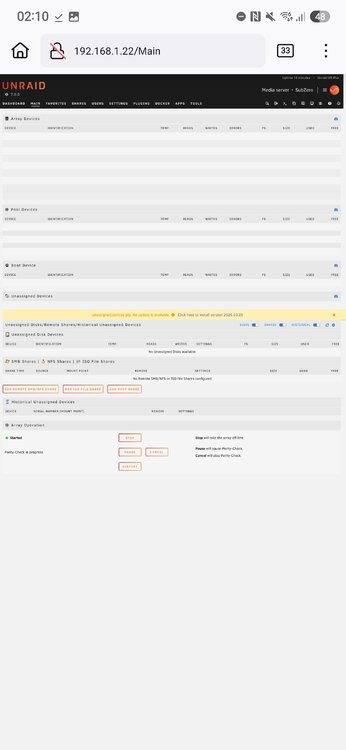

I'm having this issue where the main tab is blank, even after a reboot. I can't cancel parity can't pause it either as it takes me to
http://192.168.1.22/update.htm
But it's a blank page.
I can't click to update unassigned devices plugon from this page either. Here is a screenshot and I've provided diagnostics below.
I've tried this on multiple devices in incognito mode with no success.
subzero-diagnostics-20250226-0207.zip
