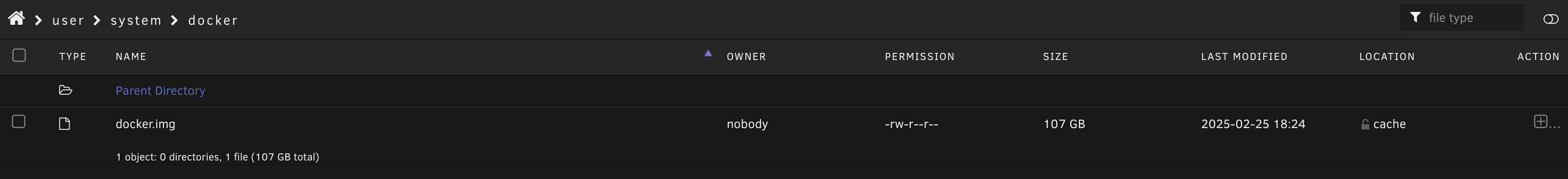

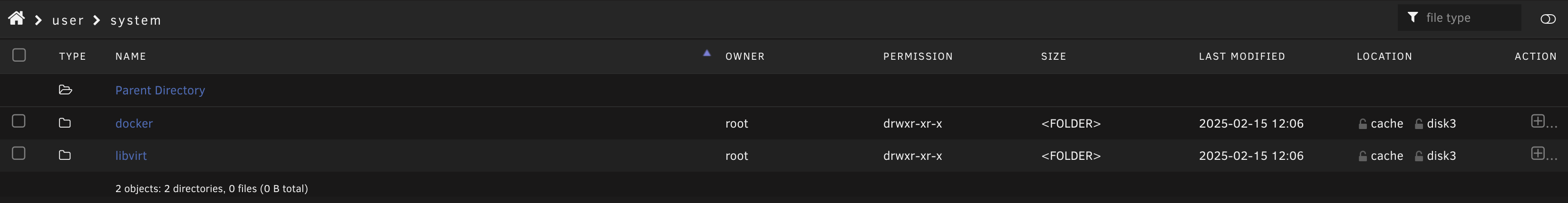

Not sure if there are still files on the array or not, maybe only folders as files show cache only.

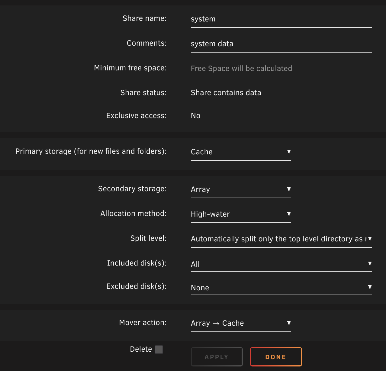

This is my settings for system share, guessing i miss configured something there?]

system and domains shares still have files on the array.
Mover won't replace files, so if there are duplicates you will have to clean those up yourself.
You will need to recreate docker.img and reinstall from Previous Apps.
