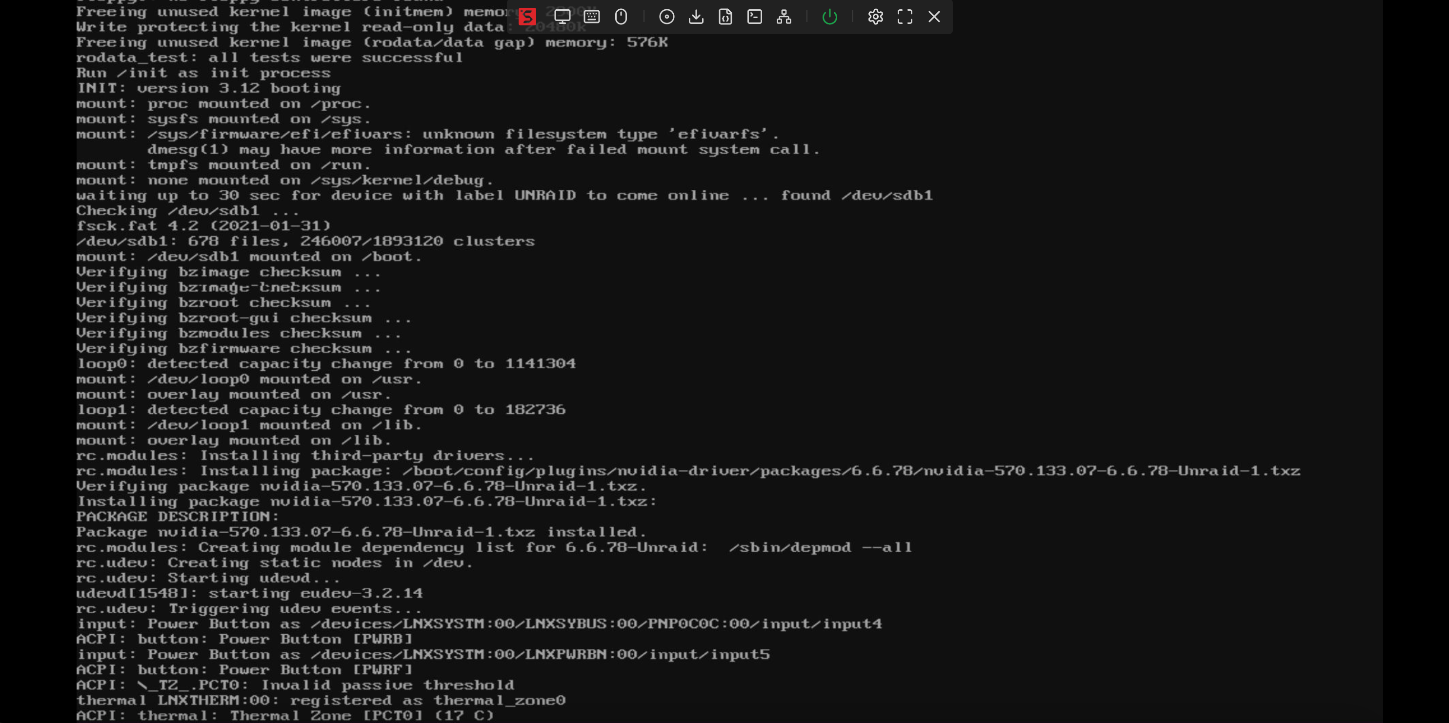

Alright I needed to do a reboot and the issue reoccurred. I boot, pass the bios screen, and reach the Unraid options page. From here I select booth GUI mode and it starts to boot with the two .bz files. It goes on and at some point stops.
Here is a screenshot of the latest attempt at booing. It got stuck on ACPI: thermal: Thermal zone [PCTO] 17c
Have you tried another USB port? USB2 port is more reliable for this.
I did have it on a USB3. I just moved it to a USB2. Rebooted, no luck.
Here is a screenshot of this boot. It froze a couple lines below the previous one.
Does the same happen with a different flash drive using a stock install? No key needed.
