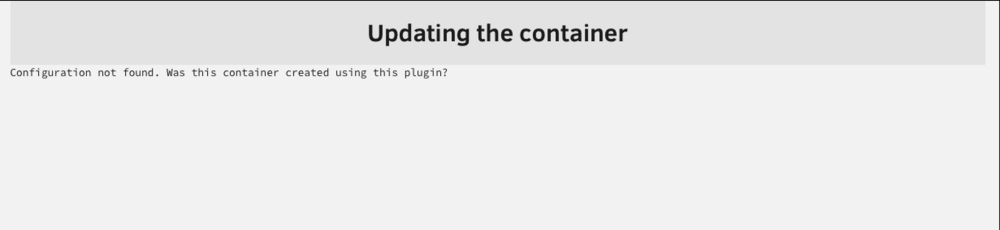

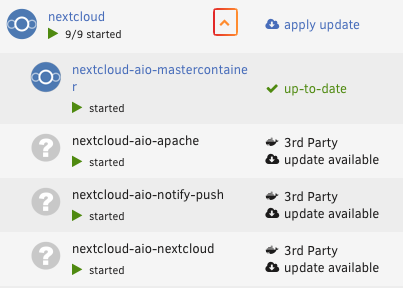

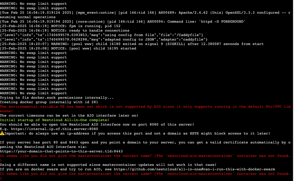

However I have run into a couple of bugs that I cannot get around the first one is that when I have tried to update by clicking on the apply update or by
stopping the containers and trying to update them individually I get this message see attached. There are a couple of other niggles however this is the main one I am running this on a Dell Power Edge Server

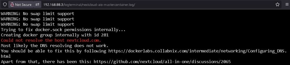

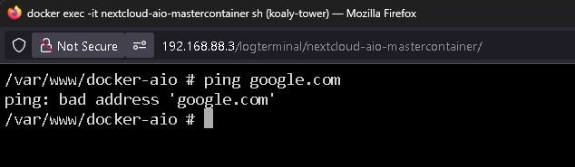

Hello guys,
I used standard Nextcloud with a Swag combination for years and after the last issue with it I decided to switsch to AIO using Spaceinvaderone's tutorial.
Installation with default settings went smoothly, but I cannot start initial setup right after the installation. The docker stops itself after a couple of minutes and the log shows that the DNS resolving does not work.
I checked other containers, they all can resolve DNS. AIO does not.
I tried to find any hint in forums, also by links in the log, but no luck. Reinstalled with no change in behaviour.
The resolution was to delete Extra parameters. May be it would help anybody, because I was completely stack. Note: I have a pfsense router.
