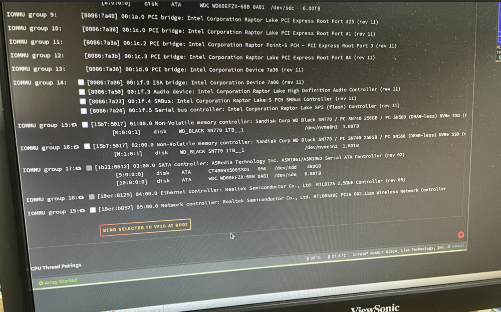

I did some hardware upgrades on my unraid server (replacing the CPU and MoBo), I can boot into web GUI mode (with monitor attached) but I don't see Unraid showing up in my router and I'm not getting any IP listed for eth0 when I enter  'ip a' in the unraid terminal. I know that my cable and router are good because the same were in use earlier today without issue. The new MoBo has a 2.5gNIC, RT8125. Here is my diagnostics file, any help would be greatly appreciated!

@MAM59Yes, I'm sure. See below terrible phone screenshot (sorry). Tailscale is for remote access to the machine when I'm away from home, only the plugin, it isn't used within any specific containers. It was working prior to the hardware upgrade.

No worries, it happens, this server has a Realtek NIC, but the stock driver is blacklisted because the Realtek plugin is installed, and apparently not working, but it's not showing up under plugins.

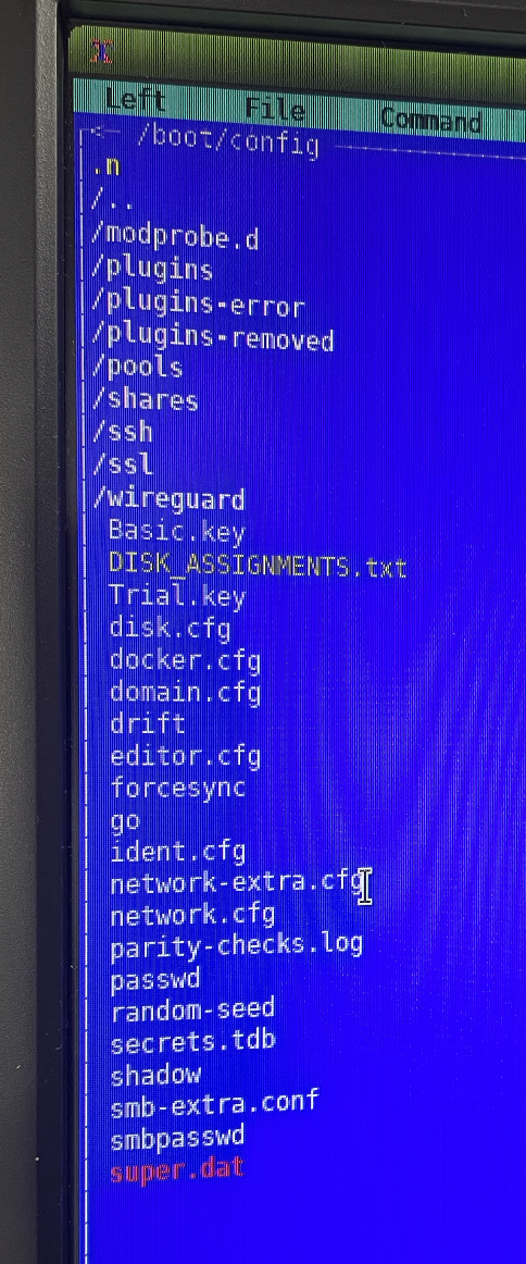

Delete the Realtek plugin plg file from /config/plugins and also delete /config/modprobe.d/r8169.conf, then reboot and if it still doesn't work, post new diags.
That was it! Thank you soo much! So I can learn, can tell me where you were looking the the Diagnostics bundle that you found the issue?
It was that modepor.d file that existed, and then confirmed the NIC used that driver, that you can see on lspci.txt
