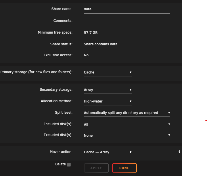

Sorry I'm sure this has been asked, I tried looking at some older posts but not having much luck.  A few months back I had a memory issue which was corrupting my cache and causing it to go into read-only mode.  I identified one of my sets of ram was causing the issue and removed it.  Havent had that issue since, but after rebuilding my cache I must have forgotten to update my share settings.  Not really sure how it happened but my data share was set to cache only.  I noticed my cache was filling up the other day and changed the share to cache > array.
My issue is that none of the existing files in my cache are moving when I manually invoke Mover.  I tried restarting my system and disabling docker with no luck.  Is there any other easy way to clean this up or do I need to manually move everything?  When I'm in File Manager, whenever I try to move a file it gives me an invalid target error or states it's not a directory even though I'm pointing it to the exact same location on my array.  Any help would be greatly appreciated!!
edit
For some reason, even files that were added after the change was made appear to be on the cache and don't move when mover is invoked

Enable the mover logging, run the mover, post the diagnostics.
Uninstall the mover tuning plugin and retest.
Thanks, just uninstalled and seeing movement finally!! Good news so far....was the mover tuning plugin deprecated?  I recently updated to 7.0 and didnt see anything about it in fix common problems
There are multiple versions and some don't work with v7, could also be a config issue.
ahh ok, thanks for the help!  Moved about 400GB of the 700 so far, looks like I'm good!  appreciate the quick help JorgeB!
