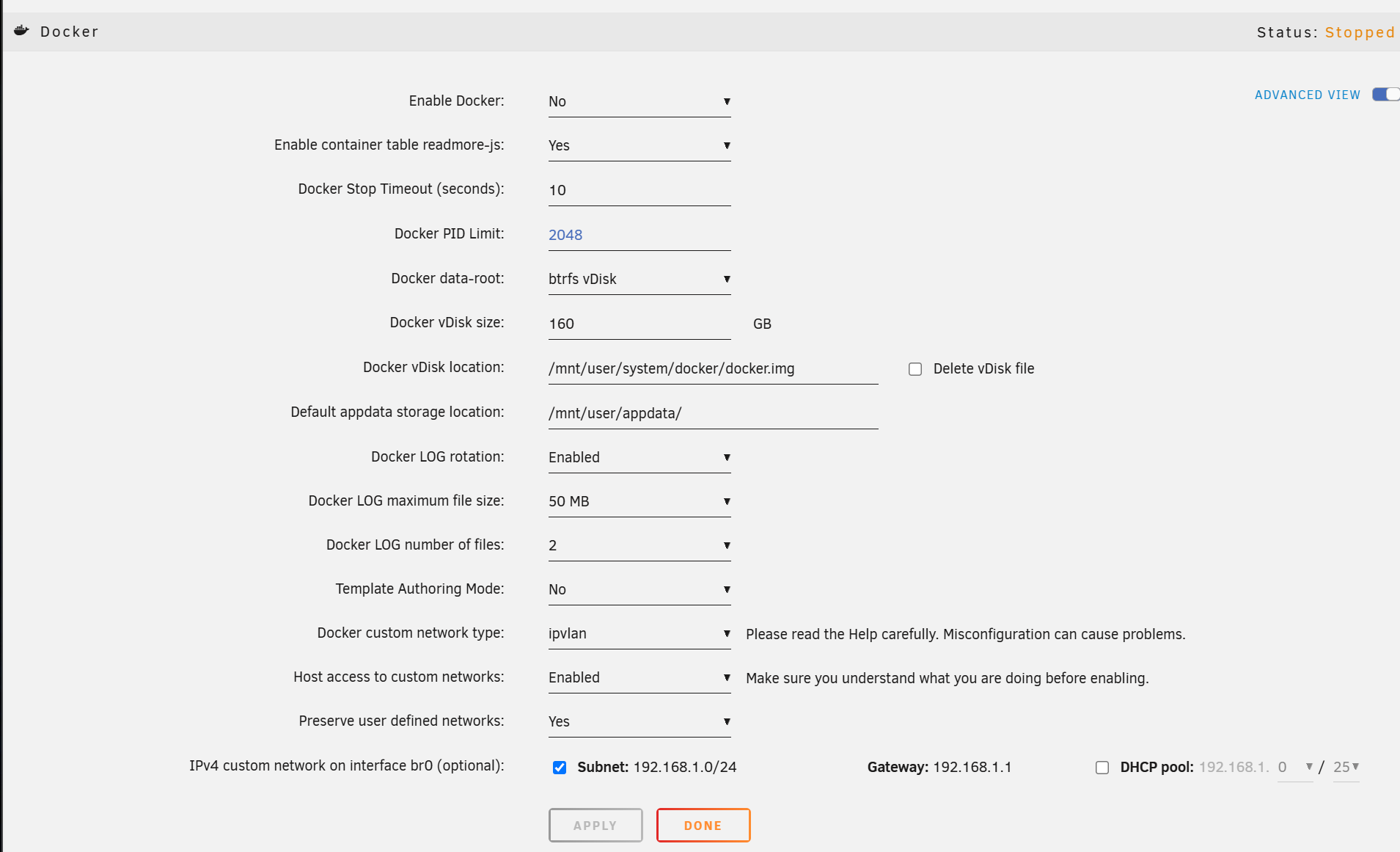

February 27, 20251 yr After updating to 7.0.1 from 7.0.0 recently, my dockers connected to my br0 network stopped being accessible, both through ngnix and the local network. I'd had a similar issue before, which I solved by deleting the network.cfg file and allowing unRaid to rebuild it. I tried this again, but am having an entirely new problem Now br0 won't show up at all under 'Network Type' when I try to update my containers, and instead I have 'None' show up in the dockers which used to have br0 assigned. I've tried deleting the network.cfg and changing my network settings around, but have had no luck. Currently I am using: Docker settings: - Docker custom network type: ipvlan - Host access to custom networks: Enabled - Preserve user defined networks: Yes - IPv4 custom network on interface br0: Subnet: 192.168.1.0/24 Gateway: 192.168.1.1 DHCP pool: not set Network Settings: - Enable bonding: No - Enable bridging: Tes Can someone please help me figure this out?

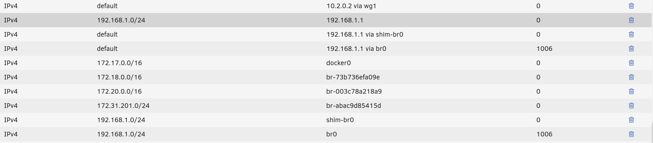

February 28, 20251 yr Author It is not, I'm still unable to set any of my dockers to br0... here are my interface details. This is the only place I'm able to see br0 referenced Edited February 28, 20251 yr by HDodd

February 28, 20251 yr Community Expert Post a screenshot from the docker settings page, with the docker service stopped.

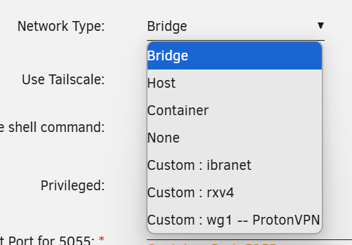

February 28, 20251 yr Community Expert Looks OK to me, which options show up for container network? You can also try recreating the docker image, in case it helps.
February 28, 20251 yr The behavior is the same as the issue here: https://docs.unraid.net/unraid-os/release-notes/7.0.0/#issues-using-docker-custom-networks Even though the settings look correct, it feels like there is an issue with this: On Settings -> Docker Settings, try this: disable Docker, then remove the checkbox next to "IPv4 custom network on br0" and Apply. Then re-add the checkbox and Apply. Enable Docker and see if that helps?
February 28, 20251 yr Author I just tried that and unfortunately nothing changed... Would checking the DHCP Pool checkbox help at all?

March 1, 20251 yr Author So I completed the above and br0 is now back, but my VPN connection no longer shows up when adding/updating docker containers... It still shows up in the VPN manager, and is able to handshake/ping, but I can't connect any of my containers to the VPN now
