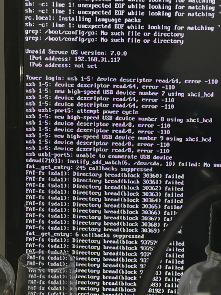

can not reach to my server after changed motherboard and cpu
updated form i5-10660k withi asrock b460 pro to qtb1 (i9-10900es) with rog z490h
no other hardware changed
but i can't reach to gui or webui now.
i can see the boot options and select

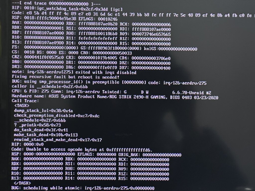

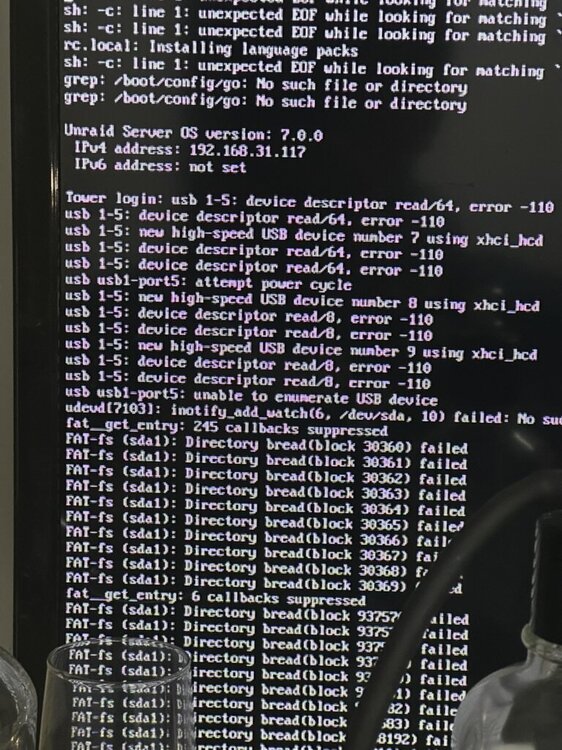

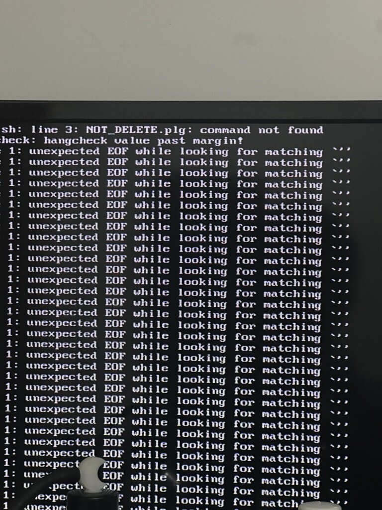

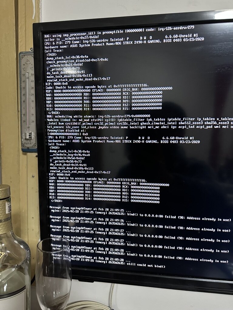

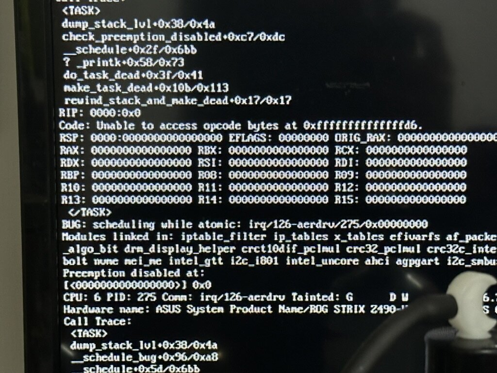

but gui mode weither safe or not, would stuck in black screen.
normal os mode, weither safe or not, web ui ip could show but can't reach.
and codes will still  show a lot after webui ip showed.
i have tried delete network config and vfio config, bit didn't help
1E5682CA-1022-4D35-A302-BC9BCA614756.heic
Solved by JorgeB
One of the photos shows issues with the flash drive, try recreating the flash drive, first backup the current one, then recreate it using the USB tool, confirm the flash drive boots with the stock install, and if yes, restore only the /config folder from the backup overwriting any existing files.
