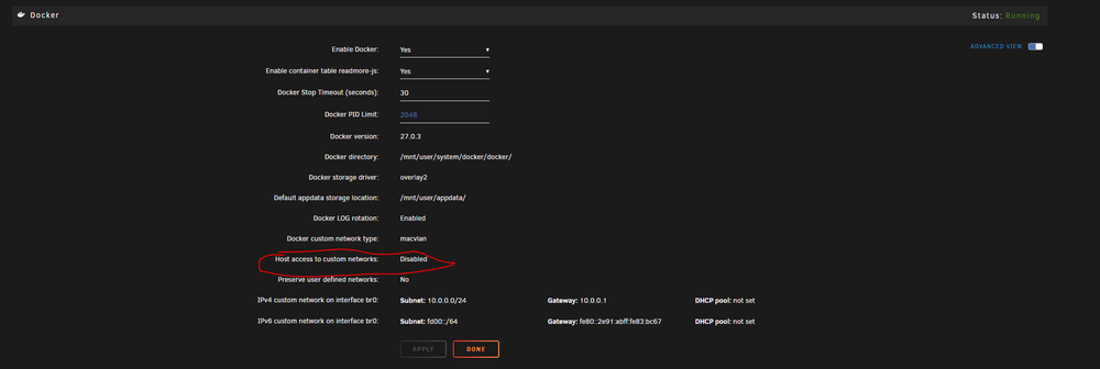

Click in the GUI on Settings then Docker
Stop the Docker Service and enable Advance view in the top right
There is no documentation about the wireguard issue, apart from a thread by me to work around it.
What it boils down to is that unraid uses br0 for interfaces, which will no longer work if host access is activated because it should use shim-br0

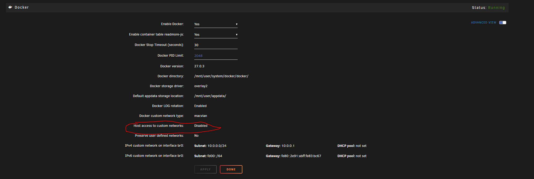

...and I fixed it again.
Seems my docker network was using ipvlan... I switched to macvlan and it worked...
Is this ok to leave it like that?
(also I disabled, applied and re-enabled "host access" setting again... could it be this that fixed it?)
