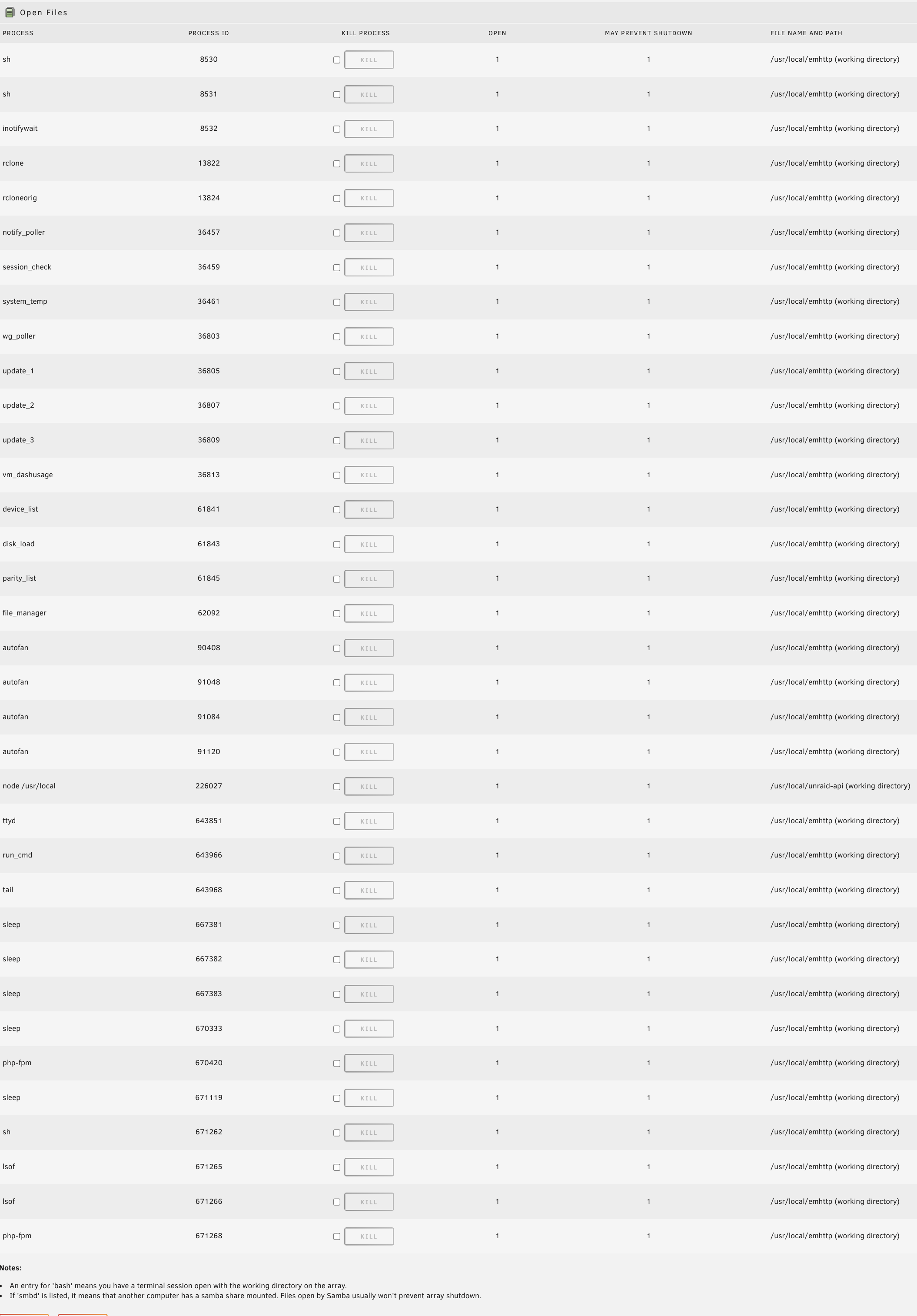

 i installed 'Dynamix Stop Shell' but it didn't help
i am using unraid7.0 while this problem happend from 6.12

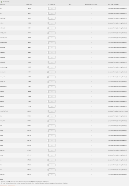

i installed this
but durring the stop array process, there is no matching between  OFP process  and system log stucking

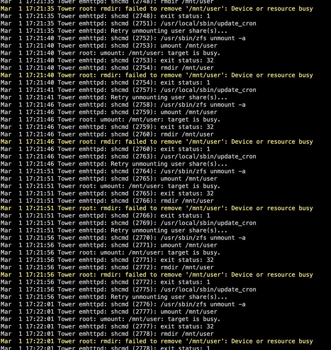

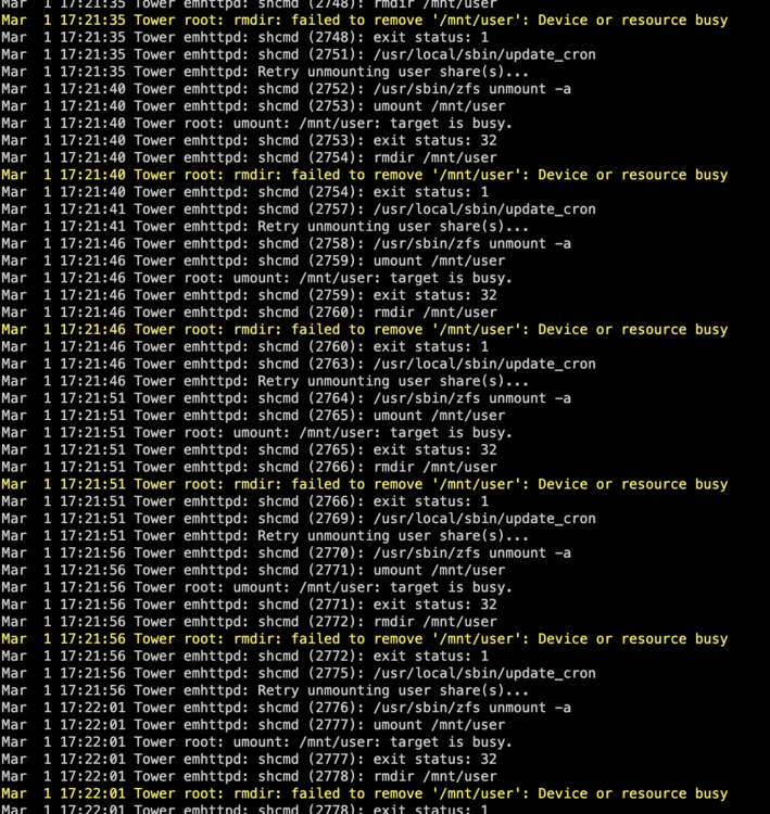

Stop the docker and VM services, reboot, and see if you can stop the array with the services disabled, if yes, re-enable one of them and retest, then the other.
 docker and vm can be stopped without any problem,  while after stop docker and vm services the array stop still stuck
