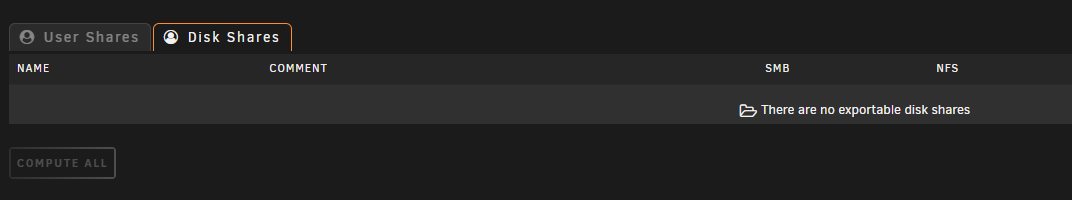

Hmmm - I dont think I every do that.  Is it related to the screenshot I added - showing no disk shares ?
In part, but you can also use with containers, for example, are they all mapped to /mnt/user/something?
I just went through the containers and they are all /mnt/user/xxxxx showing on the dashboard docker tab.
