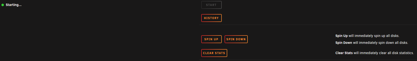

I just upgraded to 7.0.1, rebooted, and now the array won't start.  There is no error message, and nothing shows up that seems concerning in the log, but on the main page it says "starting..." and it's been like that for 30 minutes.

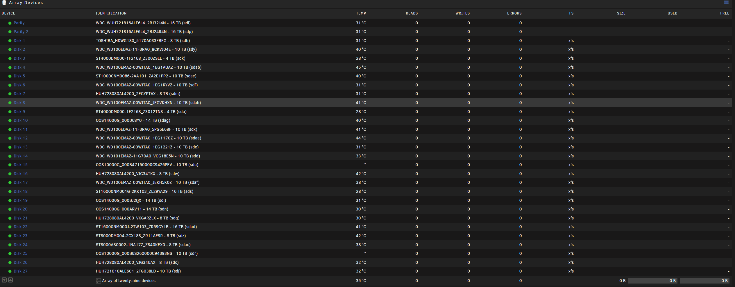

All the drives show up in the main list:

Tried turning off auto-start array and rebooting, when it came up it immediately says "Starting..." for the array.

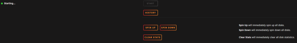

The array still says it's starting as soon as it boots, cache drives now show as unassigned devices, no other changes.

So it seems to work fine in safe mode (except of course for all the plugins being disabled).  But every reboot into normal mode results in the system saying the array is starting, but it just sits there.  There doesn't seem to be any way to cancel or stop the array starting up, and every time I've set auto-start array to off it goes back on after a reboot.  I removed some plugins I don't use anymore but it hasn't seemed to help any.
