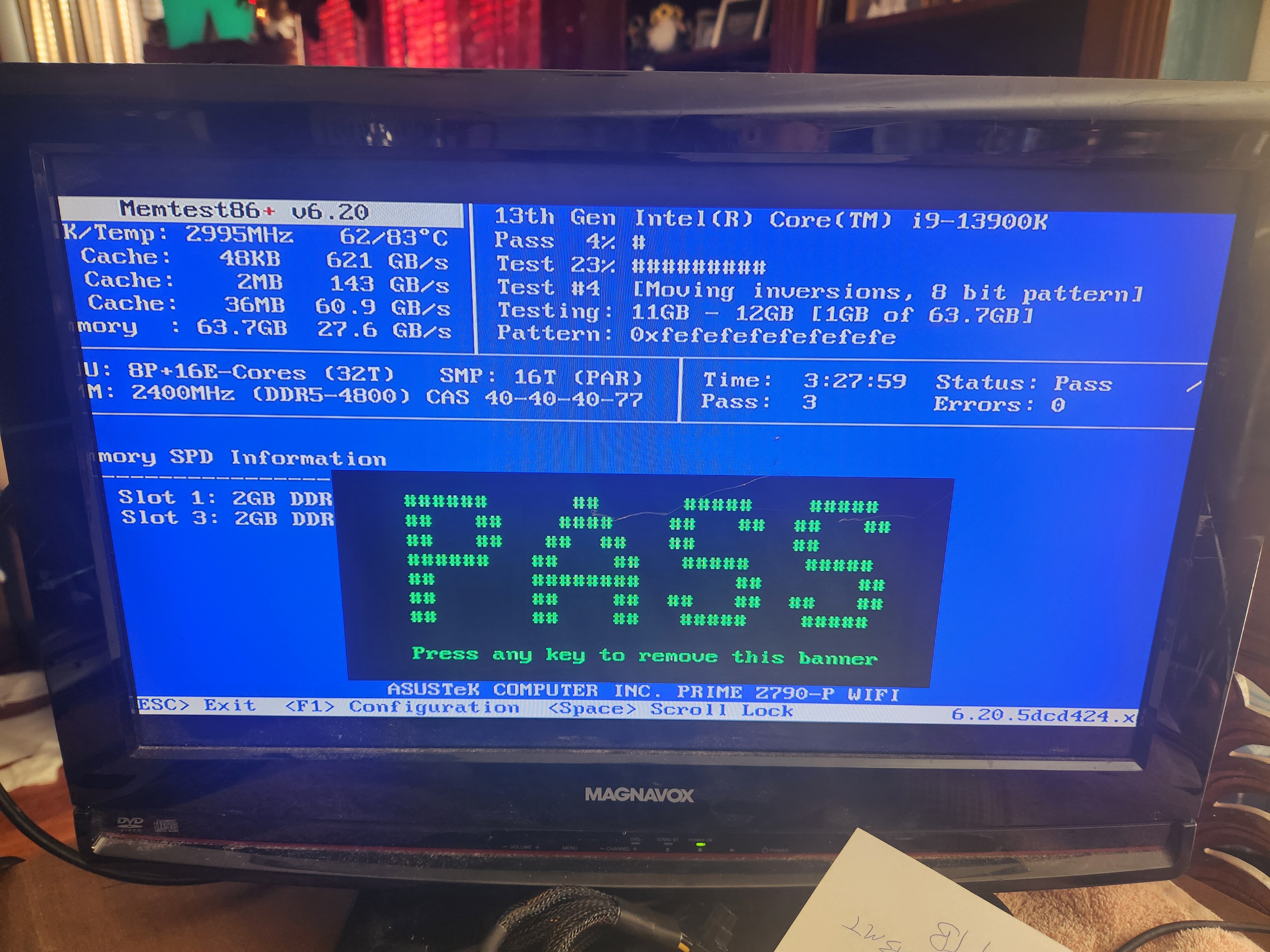

Unraid driver is crashing, this is almost always a hardware problem, most often RAM related, but since you have a 13900K, it could also be the Intel 13/14 gen issue.
The mem test was a pass. So I'll try replacing my motherboard
