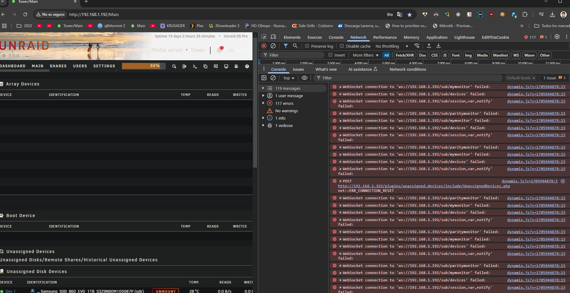

Hello,
Is not the first time that happens, I restart the server and it works again.
I dont know why happends that.
When that happens I cant acces via website, only SSH and restart the server...
The dockers and others still working

Restarting service it works again without restart the server
/etc/rc.d/rc.nginx restart
