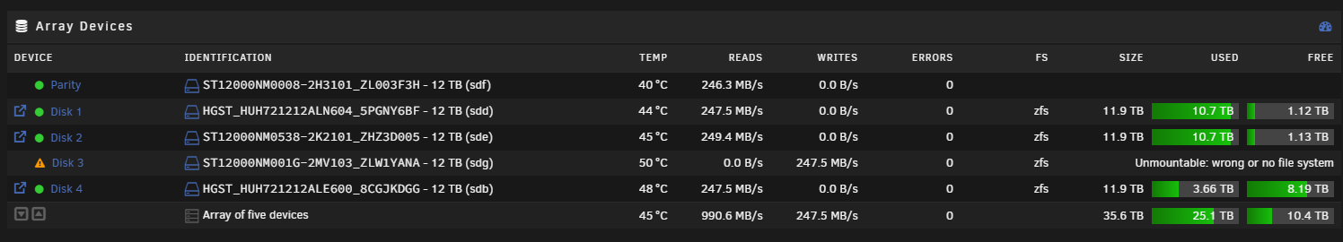

A couple of weeks ago one of my four array drives died and I've been emulating that drive with parity drive for the time being before I god the replacement drive.
I just right now received the new drive, but just before I was going to get it, yesterday another one of my drives suddenly stopped working.
In the array it shows up as "Unmountable: wrong or no file system". When the previous drive died it didn't show up like that, it just gave me I/O errors and gave me warnings, etc. This one just showed up like that out of the blue.
So right now I have Disk1 and Disk2 working properly. Then the Disk3 is "Unmountable: wrong or no file system". And then Disk4 is unassigned and emulated with parity drive.
I actually had way more data on Disk3 than the Disk4 (Disk4 was a recent purchase, like a month or two ago, about 2-ish TB used from 12 total, while 12TB Disk3 was almost all the way full)
What do I need to do to fix the situation?
I don't even know what kind of logs to post here for anyone to help me out, but i really need help though.

Finished rebuilding disk4 onto the new drive that i had successfully.
Then I stopped the array, removed disk3 and started array like that.
Then I stopped it again and re-added disk3 again and now it started rebuilding disk3 too, but it is still showing up as "Unmountable: wrong or no file system"
Does this make sense? Is there even a chance for this to actually complete?

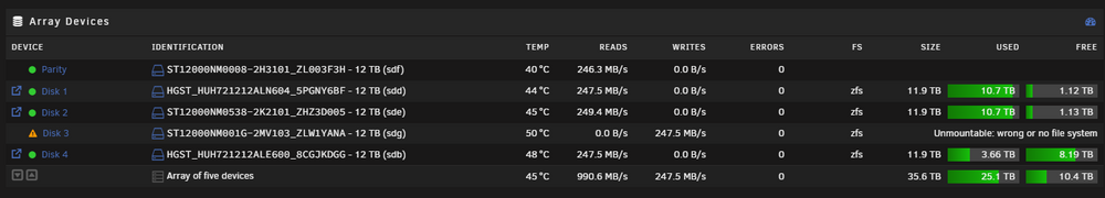

yes, i know you told me that, i just thought you meant the data can not be rebuilt so i had to format it because of that... but it is rebuilding now.
or at least i think it is.. is it not? i mean its doing something. all the disks are active at about 250MB/s doing something.
should i just give up and cancel this?
It's rebuilding, but it's rebuilding the same corrupt filesystem, if there's data there that you want to try to recover

ok. whatever. f* it. i formatted it.
but now that drive is emulated too.
how do i re-add it properly to the array?
and also, do you think my old disk4 is worth keeping again? i'm so afraid it is actually dead or defective. it had one crc error too before btw.
Since you've started a rebuild, you will need to let it finish.
