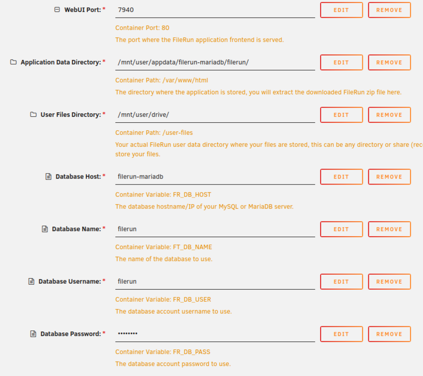

  1. Install FileRun from the community applications store and configure the template as necessary, then create the container and allow it to start

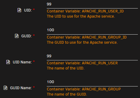

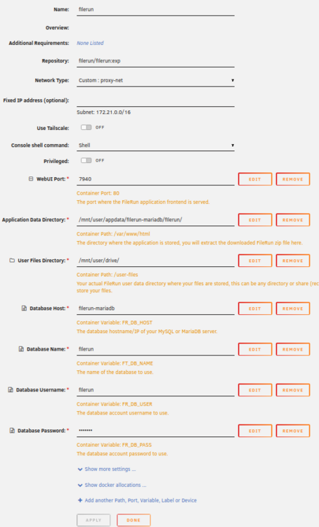

  7. Stop the FileRun docker container and then edit the following values in the template:
    • Change Repository from filerun/filerun:8.1 to filerun/filerun:latest
    • Add the following in Extra parameters: --user 99:100
    • Scroll down to the template variables and remove all 4 of the following APACHE_* variables if they exist (press Show more settings to expand variables if hidden):
      • Remove APACHE_RUN_USER_ID
      • Remove APACHE_RUN_GROUP_ID
  8. Hit Apply and wait for the container to update to the latest image and start up again

Couldn't leave this alone and I'm in.....
Managed to get wordpress running through Nginx so had a go at Filerun, set up the databse (MySql) and Filerun containers but the Filerun one wouldn't start, checked the logs and only problem was
Error: The directory named as part of the path /var/www/html/system/data/temp/supervisord.log does not exist
thought this could be permission related and saw there was a permission step later in the guide so bought the licence, downloaded the files, uploaded to the server and unzipped, had an chown: missing operand after ‘99:100’
Try 'chown --help' for more information at the end but the container started.
I tried to configure Nginx but it wouldn't have it although I did get it going later after I'd got Filerun working
Added the domain name to the hosts file entered it in a browser and got ot the setup, as an aside I did inadvertaintly go to the web ui from unraid and got to the setup page although I obviously couldn't set up from there and like it says in the guide once set up it's not licensed to run on that.
I then just ran through the setup which took a couple of goes as my Bitdefender kept blocking things.
Only problem at the minute is setting up the storage path but that'll have to wait until later.

I also found that you have to set the apache user and group to 99 and 100 just like @asynic did as this is the only way to fix permissions.
By this do you mean you had to set the APACHE_RUN_USER_ID + APACHE_RUN_GROUP_ID environment variables in the template to 99 + 100? Or is there elsewhere a change is necessary? I ask this because the template should by default have these preconfigured so it works out of the box.
Edited by ImSkully
This: image.png.285c4a3c0994f09fb634ca1baf55f5ca.png
If you leave it as the default names as "nobody:users" it doesn't work.
That's odd - APACHE_RUN_USER and APACHE_RUN_GROUP variables are intended to be the actual UID names and this is how I have always used it which works perfectly fine for me; this is also inline with FileRun docs which shows an example docker-compose.yml which uses these variables as string values of the UID/GUID name alongside the *_ID variables which is what the actual numeric IDs are.

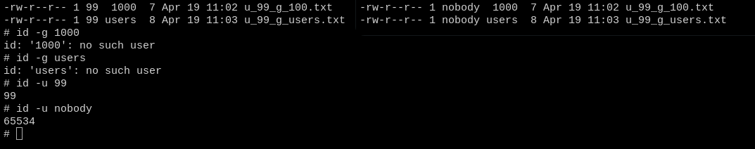

If I leave it at the default I get UNKNOWN user for my files/directories it also creates issues with creating new files and such
In my configuration it's only working with UID=99, GID=100,UID Name=99, GID Name=users
Otherwise the mapping doesn't fit:
(left side docker console, right side unraid console)
The username nobody is 65534 as standard value in docker -> mapping do not work
Unfortunatly the mapping is not the only issue. Any file created in filerun can renamed but not deleted.
Maybe the mask should be set to 777, current value is 644. I tried to set a variable "UMASK=777" but without any effect.
