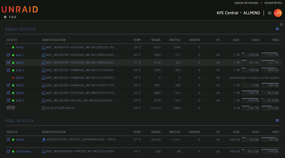

Hello,
Today I just found out 1 of my disks (sdg) suddenly show as unmountable in array.
I'm assuming no data lost at this point. But unsure what is the best option to proceed.
Can anyone help guide me here?
Regards,
diag log attached.
allmind-diagnostics-20250303-1620.zip
