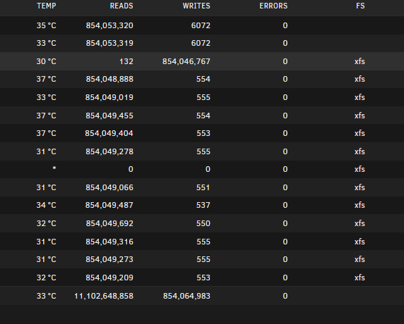

I'm trying to rebuild Disk 1, and it's already been 11 hours and it's only 3.5TB in.   The speed keeps fluctuating but as I sit and watch it, it doesn't even go a minute before it pauses for 5 to 10 seconds, and then continues.
I thought it might be drive temps, so I changed the settings to 55C  and to stop 1 degree under.  That didn't help.  Maybe it wont re-check the tuning settings while it runs, I thought.  So I put a big house fan on my open server case and have it blow in.  Drive temps seem good.  (none were over 39 to begin with)   So I thought maybe the HBA card is hot, so I moved the fan to really blast it  (I risked touching the heatsink while on, and it didn't even feel warm let alone hot)   It seems to keep the drives cooler too (pic attached)  but it still keeps pausing.
So if it's not temps, does anyone know what else could be making it pause all the time like this?
(Just saw it up to 178MB/sec and down to 10 hours, then it paused and dropped to 36MB/sec and it's 1 day 12 hours)
