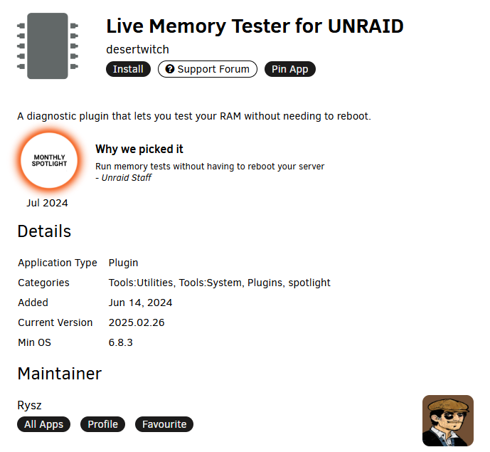

There is also memory live test plugin you can install and test 1 GB or reboot the system and run memtest to confirm its not faulty hardware ram...

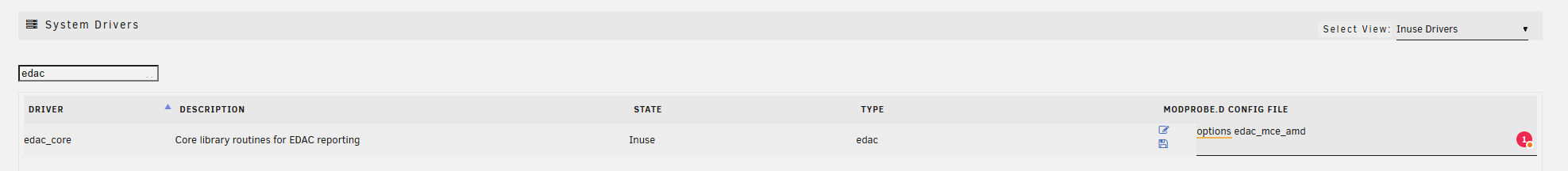

root@Docker:~# lsmod | grep edac
edac_core              77824  0
root@Docker:~# modprobe edac_mce_amd
modprobe: ERROR: could not insert 'edac_mce_amd': No such device
root@Docker:~#
