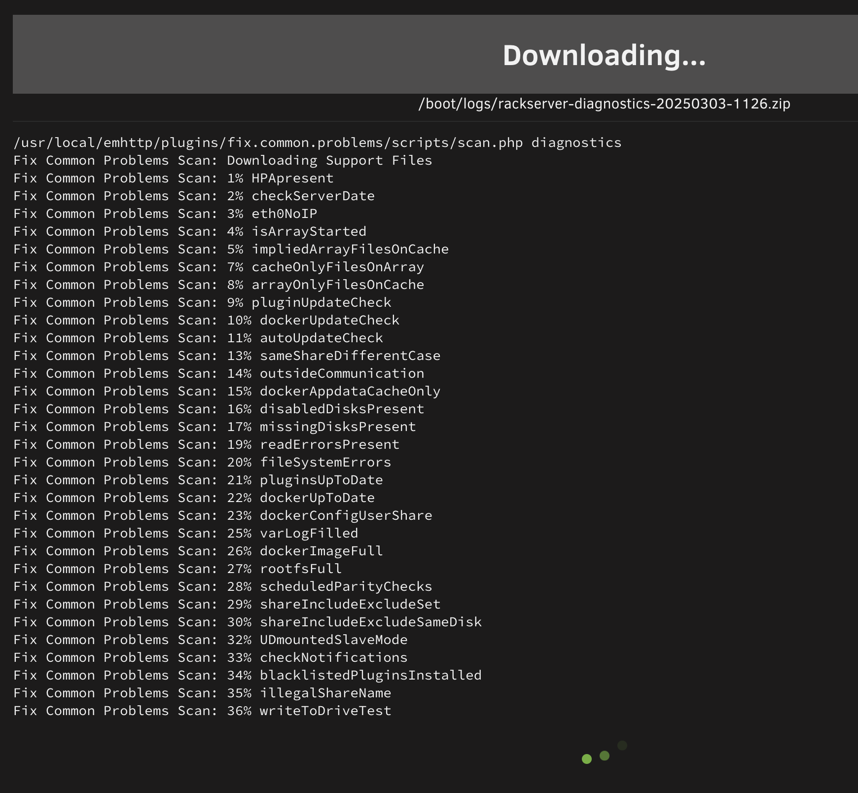

However, the system will not reboot, I cannot generate diagnostics either, it hangs here:

P.S. would recommend reporting the issue with FCP preventing getting the diags, I believe it's the 2nd time I've seen this in the last couple of days.
Will do.

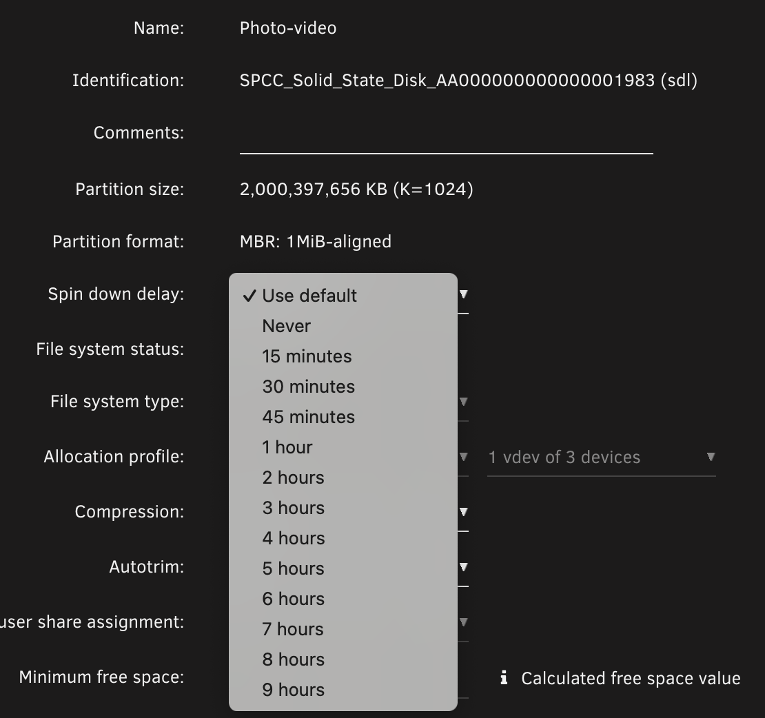

As a troubleshooting step, I would like to disable spin down for this zpool. It has the following drives present:
If I click on the first drive I see the option to change spin down:

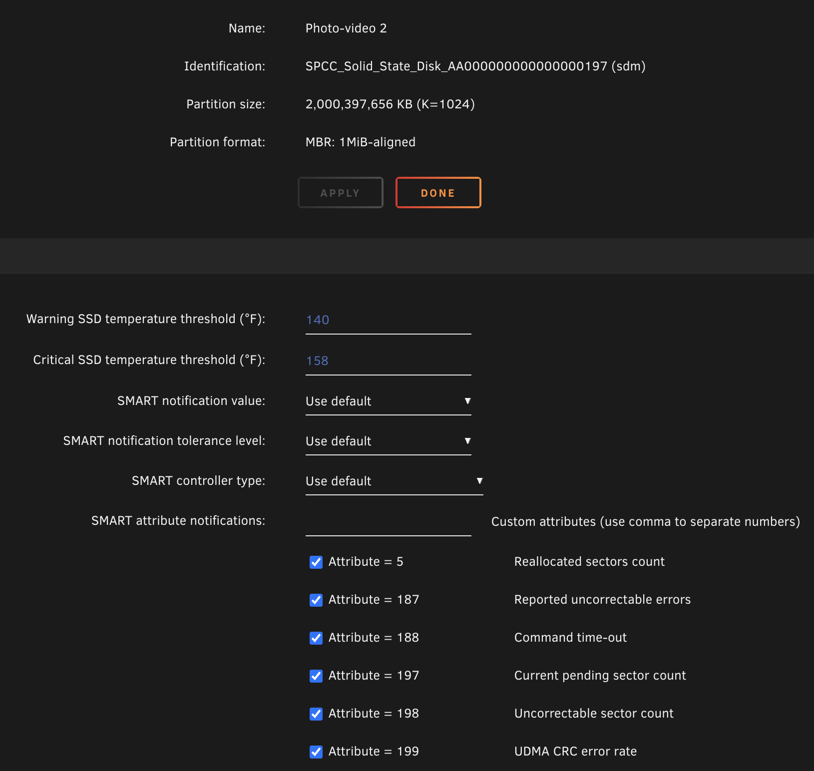

However, when I click on the other two disks, they do not have that option:
Will the other disks follow the setting of the 1st disk, or is there somewhere else that I need to set this?
Thank you!

On 3/4/2025 at 8:59 AM, JorgeB said:
They should.
FYI, the pool is not obeying the setting from the first disk. Is there a way to set it on the other two disks so they are in sync?
That shows the first disk is up and the others down, if it's not obeying it should the other way around, please post the diagnostics after the pool was supposed to spin down.
Sorry, I stated in the text what I was doing, but the screenshot shows something different. Sorry for the confusion.
It is doing exactly what it has been configured to do. As a troubleshooting step, I wanted to disable spin down. I'm pretty convinced now that it has nothing to do with the issue, but regardless, I don't want this pool to spin down.
I have set the first disk not to, but the remaining two disks still spin down and don't have a setting in the GUI I can find to set them not to.
It is currently behaving exactly as configured from my perspective.
Would you like me to submit a bug somewhere about it either not obeying the config of the first drive, or, the setting missing on subsequent drives?

Let me test and if I find the same thing I will create a bug report.
Yeah, this is a bug, in 6.12 there was a setting per pool device, in 7.0 it's only for the main pool device, maybe the intention was to have that one apply to the remaining pool members, which would make sense, but currently it's not possible to set a custom spin down for the other pool members, I've already reported this to LT, and it should be fixed in an upcoming release.

Turns out there's still a bug but only for the first time you set a custom spin down for a pool, only the first pool member will spin down, if you reboot, or just re-start the array, all pool members should spin down from then on.
Confirmed. I am seeing now that after rebooting to replace the controller in the server, none of the drives are spinning down anymore, as configured.
Thanks!
This bug has been fixed on 7.1.0-beta.1, not sure yet if it's going to be backported to 7.0.2
