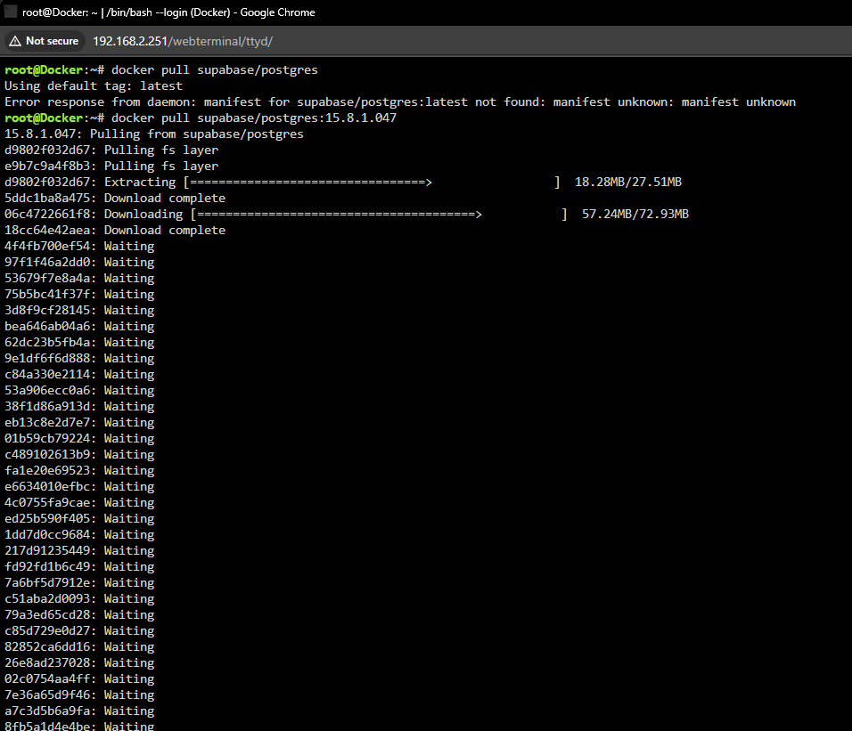

yes the pull works but not as expected...
https://hub.docker.com/r/supabase/postgres/tags
I went with the top tag.
root@Docker:~# docker pull supabase/postgres
Using default tag: latest
Error response from daemon: manifest for supabase/postgres:latest not found: manifest unknown: manifest unknown
root@Docker:~# docker pull supabase/postgres:15.8.1.047
which means if you want to use this, you will need to spefiy the tag int he repo...

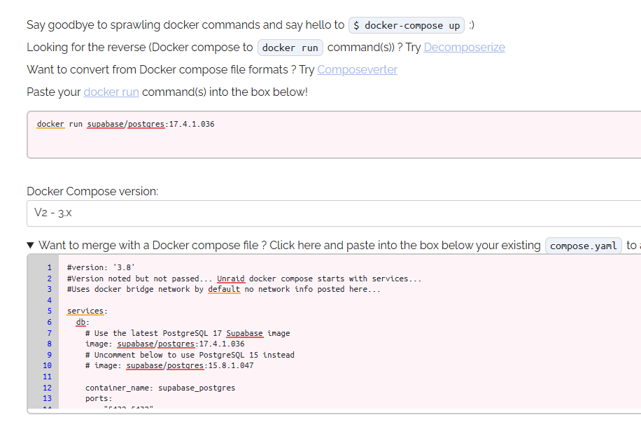

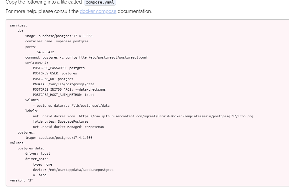

yaml line syntax required... I can't guarantee it anymore with inline text to post do to forum new update...
I would recommend running it through
https://www.composerize.com/
and copy paste the
This will also remove the coments of whats what ... coment out version...
docker-compose.yml

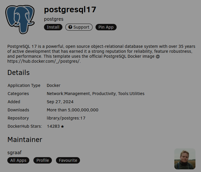

what I mean by using the tempalte is:
install postgress v17
click advnce togle...

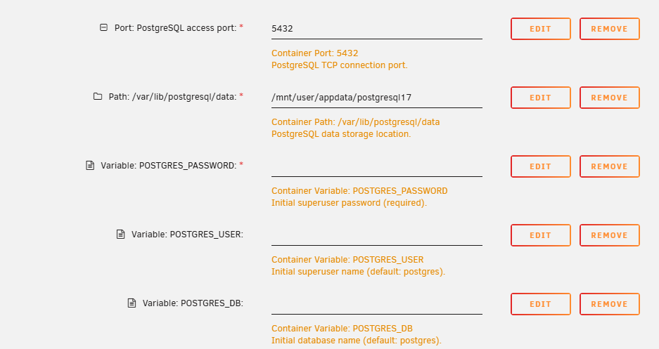

change the repository to the docker image and change the Registry URL: to the docker hub page...
so:
repository would become:
supabase/postgres:17.4.1.036
and
registry URL would become:
then edit and add the other variables...

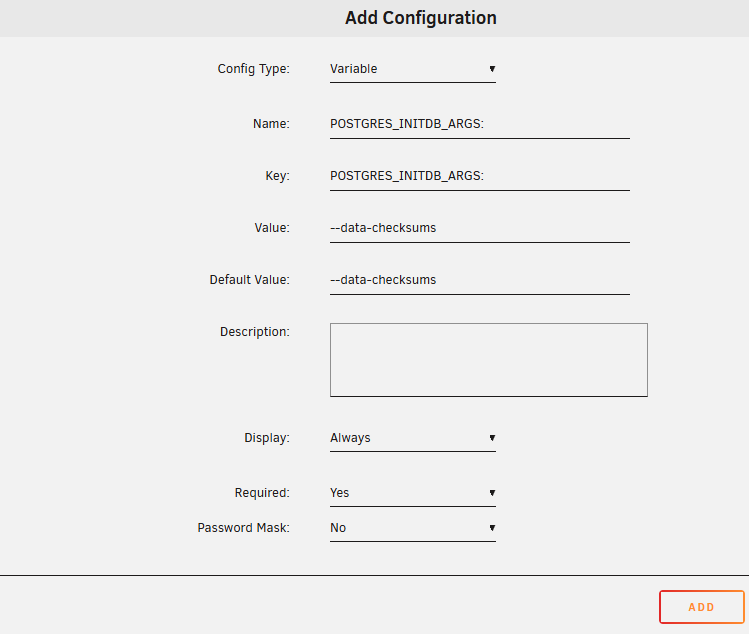

Bare min:
want other options then add them
such as var: POSTGRES_INITDB_ARGS:
with docker authoring enabled you can then save it as a unraid template and github host it on your own CA unraid Repository.
