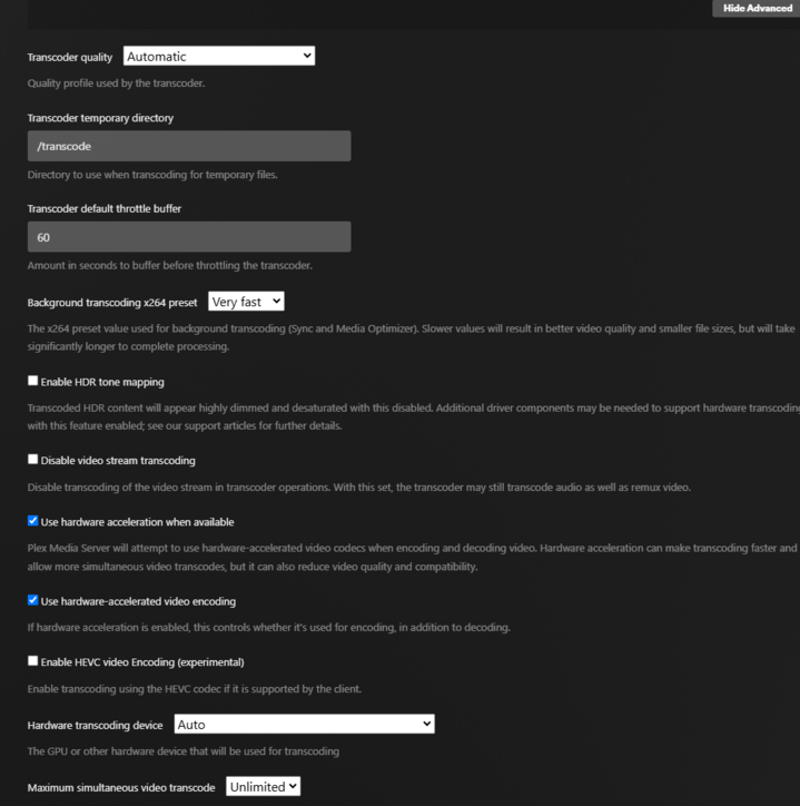

I upgraded my box from an older Risen 5600G to an Intel 12500k system last week.  It's much snappier and transcoding in plex, while I did get it to work on the Ryzen iGPU, it was laggy and seeking through movies was just straight up broken.  With the Intel system, that vanished and things were good.
