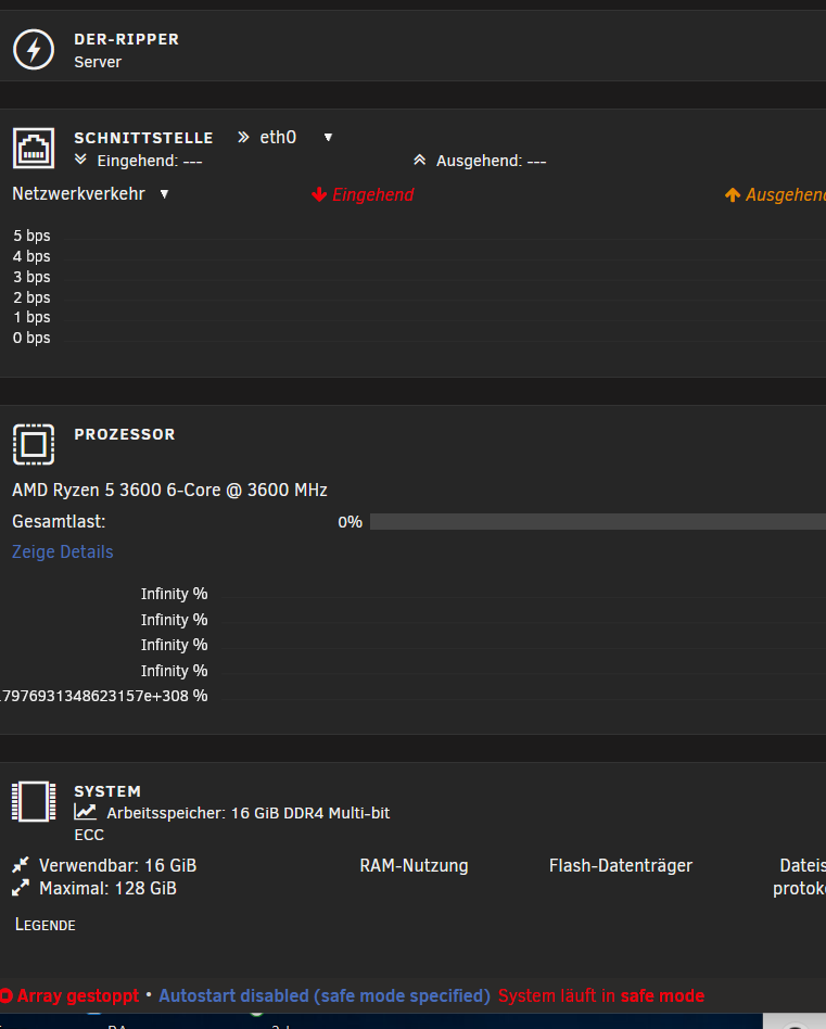

now i have also this topic.
but i have not installed the Nerd Tools.
how can i find out what is going on and which plugin i must delete?!

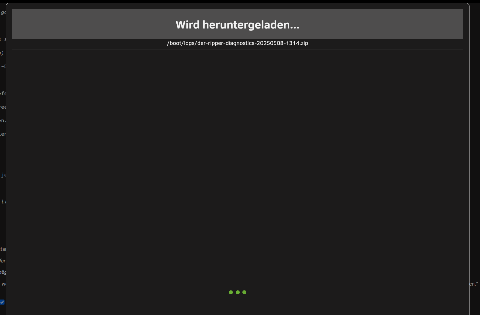

@luckyheiko You are likely to get better informed feedback if you attach your system’s diagnostics (with everything in the one zip file) to your next post in this thread. It is always a good idea when asking questions to supply your diagnostics so we can see details of your system, how you have things configured, and the current syslog.
I wanted to do that, but unfortunately, since this issue, I haven't been able to download the diagnostics.
It keeps crashing.
the only thing i changed was a Mainboard switch from a ASRock B450Pro4 to a Asus X570-P
It keeps crashing.

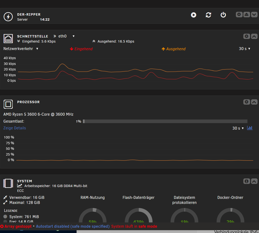

Have you tried booting in Safe Mode to eliminate a plugin causing the issue?
Note that you only need the console to be able to get the diagnostics - the webGUI is not needed.
It's not that easy for me to get into safe mode, since I don't have any graphics on the board
ok, it must be one of the plugins :(
but which one?!
grafik.thumb.png.0220a230b364d275c204577fa93adce0.pngder-ripper-diagnostics-20250508-1319.zip
Edited by luckyheiko
in my case it is the unget.plg + unbalanced.plg
without this plugin unraid works

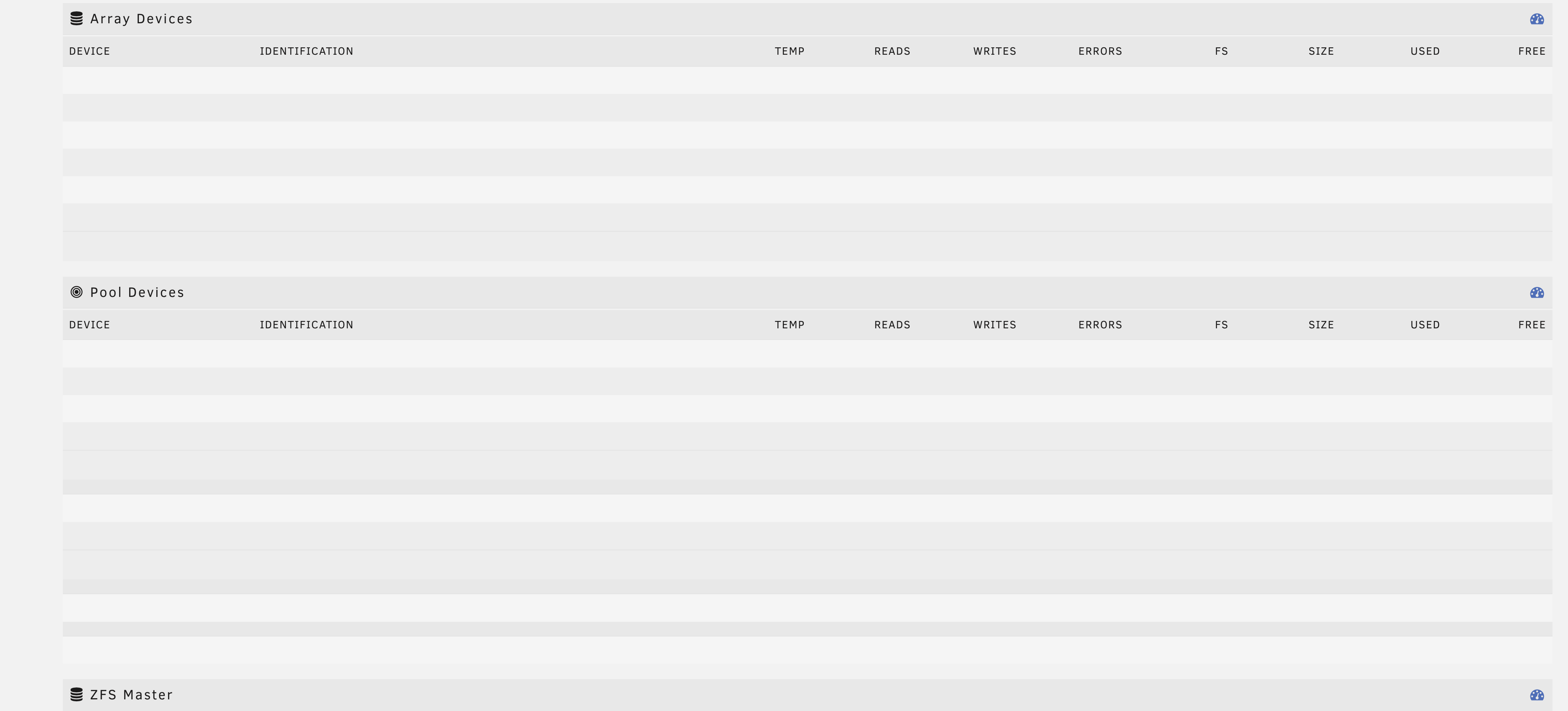

Hi Everyone
Has anyone been able to get to the root of this issue? I don't even run that many plugins, and since a reboot yesterday, I have lost most information from the portal, including disks, etc. Upgrade to 7.1.2 was last week
Everything seems to be working fine. but Nginx ( I assume ) has got itself in a twist. i have tried nginx restart tec. i have removed 2 plugins that I thought might be the problem.
Diags attached.
Update after safemode boot..Defo a plugin issue,, but not sure which ?
tower-diagnostics-20250520-1031.zip
Edited by lupine
May 20 09:04:26 Tower publish: curl to session failed
This is when those errors started. You logged in just prior. What did you do when logging in?
Also, nginx had some weird issues after your reboot and it started the containers. What did you do at that point to get the UI back up and running (or did you notice it at all)
