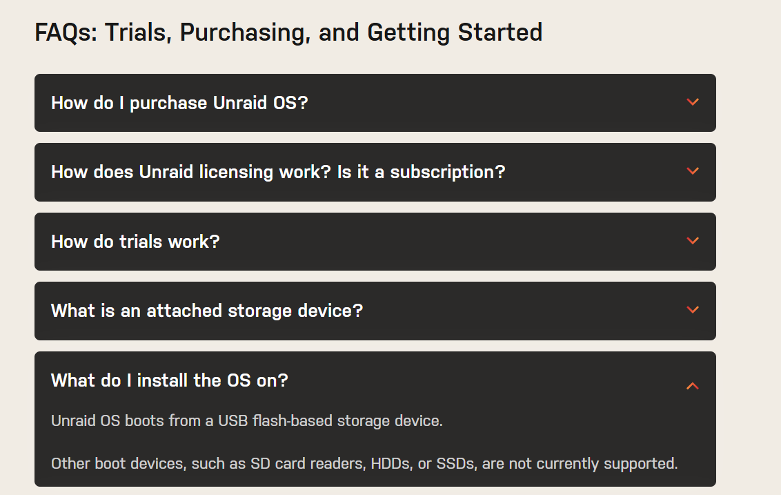

I have used TrueNas for years, and recently my Google Drive backup was zero size, and I do not trust the rclone used there anymore. I heard that your UnRaid was a lot better for that kind of routine, but nowhere and no one said that must run from a pendrive or depending of a plugged one definitively.
What.
Yeah, I missed that one.
Genius decision to put an entire NAS platform depending on a pendrive.
