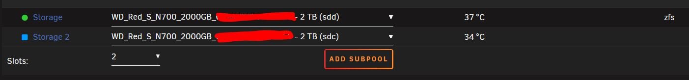

So I have a single drive zfs pool and I recently got a second identical to add a mirror drive to pool. It seems however I'm unable to add the new drive to the pool from the UI.
If I change the pool slot size to 2, add the new drive to the pool and go and start the array, it gives me a new device too small error. The 2 drivers are identical so this shouldn't be an issue? During all of this the FS selection is greyed out and acting like the pool only has 1 drive so it never changes to show to option to do a mirror.

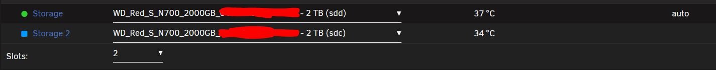

If I instead change the FS on the first drive to auto before adding a second slot to the pool then add the second drive and start the array, the second drive isn't assigned to the pool and just remains unassigned.

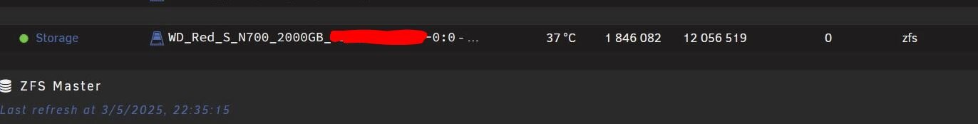

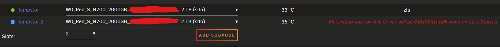

If I set FS to auto before the second slot being added and add the second drive then I can set zfs up with a mirror with 2 drives. It still refuses to assign the second drive apon starting the array.

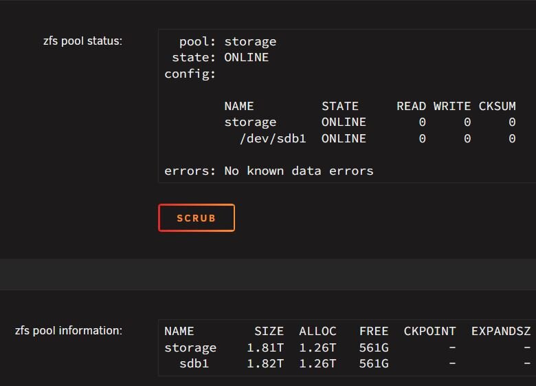

Nothing weird in the pool status either

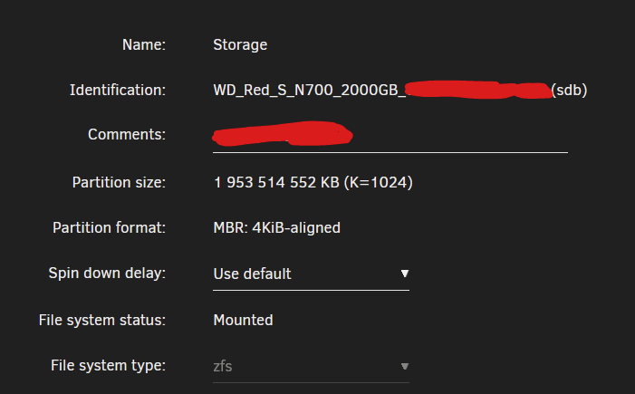

That is using the old partition layout, when was that pool created? With zfs should be fairly recent.
For performance reasons, and for many years now, Unraid creates 1MiB aligned partitions for SSDs, so it will have a little less space, and hence the error.
