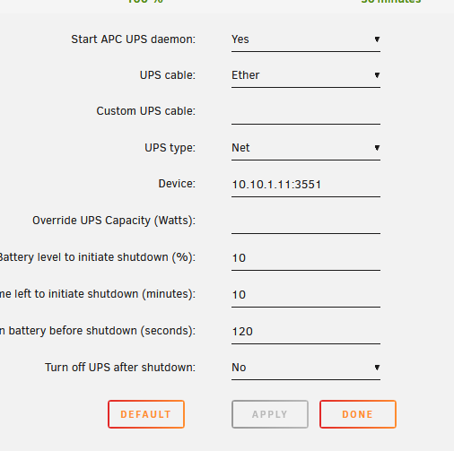

Should be able to set it up in 'settings/ups settings' - this is how I have mine set up for my backup server:
Thanks for the response,  the I configured my second unraid machine with the ups config as you suggested,  what port number should i use,  mine is showing UPS data without putting in the Port number
thanks for the help
Bob
3551 is standard apcupsd communication port, so default port is used even if not specified.

Great, thanks for the explaination,
everything is working perfectly,
thanks to all for the info and support.
