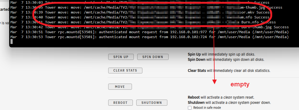

I am in the middle of a large "Mover" operation. Mover is running properly, but on unRAID's main screen, it does NOT show it as running. I do NOT have the "Mover Tuning" plugin installed. When I had it installed, it was fake-moving files to /user0 folder.
I also do NOT have "Automatic Turbo Mode" enabled.
Is this a bug, or is something not set up correctly? Please see screencap below:
Thank you.
Is it showing as running within Settings, Scheduler, Mover Schedule?

Its 1 Hour, after that, the status is gone from the main page. The schedule page does still display it as running.
Edit: Looking at the code, it seems okay. parity_list is also running. mhmm
Edit2: It seems like the websocket mymonitor just stops responding at all after 1 hour.
This is the response after i freshly started the mover. Before that. i got 0 data, absolutely nothing.

Hi…. My server is early-on on a drive data rebuild (16%), and mover button was disabled because of this. I woke up and drive data rebuild says it will take like 20 days. Last night it said it was going to take about 28 hours. I see on the Main page that the Move button is available to push. I go to Settings > Schedules and it reports “mover as running”.
so two things… One, the mover status is not reporting like my original post. And two, scheduler activated the mover overnight even though unRAID was in the middle of a drive rebuild. This is concerning as mover should be not be running.
is this an issue? I have about 1TB in cache that is copying to the array.

Technically it is OK to run them in parallel, but they badly affect each others performance so it is more efficient to not do so.
Not sure why mover is running with a rebuild in progress!  Maybe it only doesn’t run if a parity check is in progress?   If you install the Parity Check Tuning plugin then even if you do not use its other features you can set it to pause ANY array level operation while mover is running/
Thanks @itimpi. Glad to hear it’s not an issue other than performance. Server is not doing a parity check. It’s rebuilding a drive that went bad and was replaced.
I assume I can either pause the drive rebuild on Main page. Or I can go to console and issue the “mover stop” command. The second option sounds better as I want the array back to normal asap.
thoughts?
