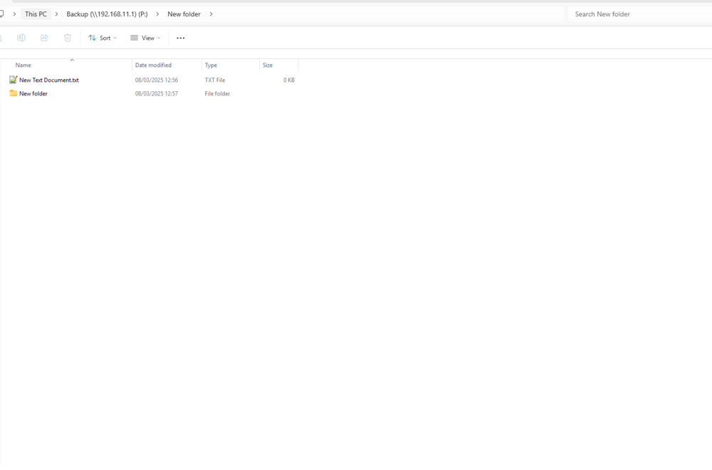

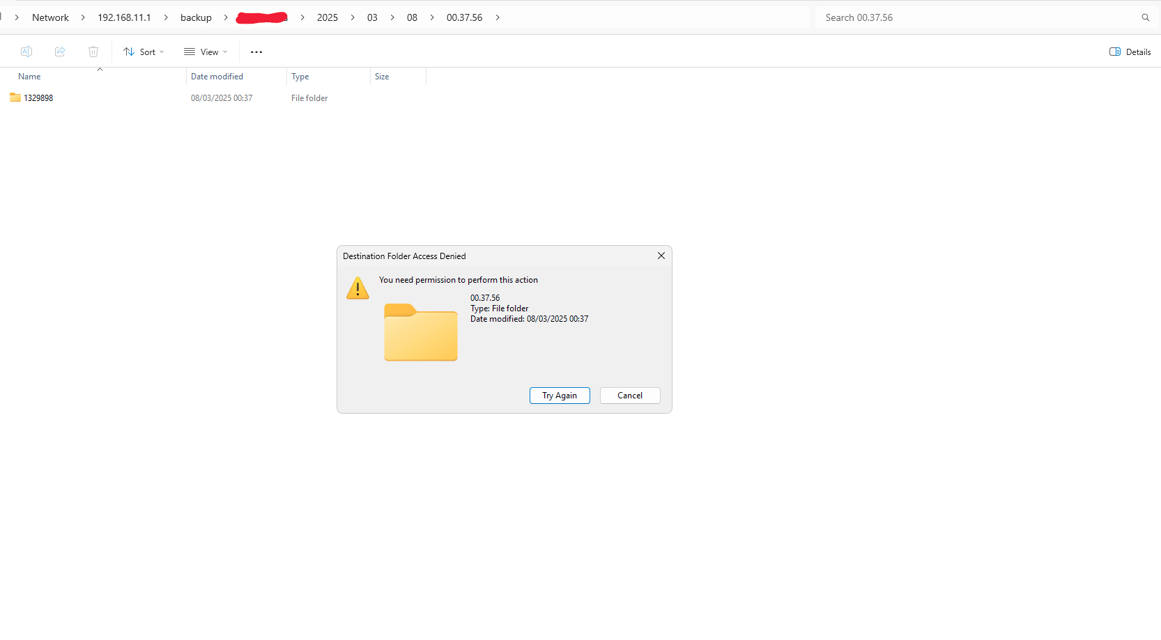

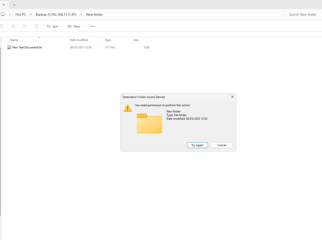

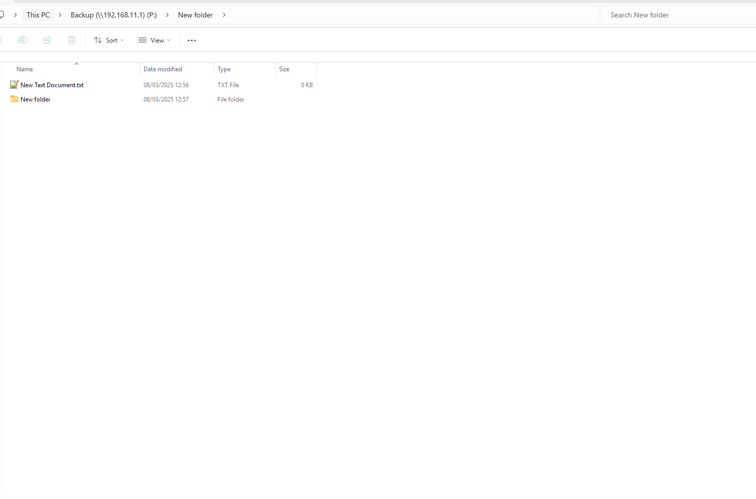

I tried creating a new folder and it errors as shown.
But if I click try again it successfully creates the folder, this is random, you can see the new text document I created had no issues. but the folder did in this case.

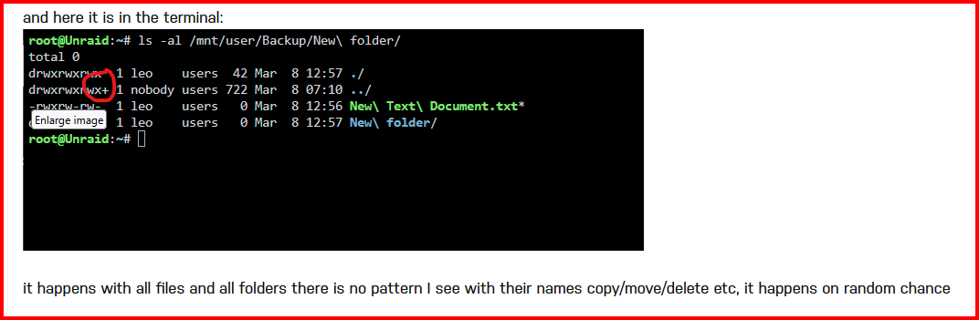

and here it is in the terminal:
it happens with all files and all folders there is no pattern I see with their names copy/move/delete etc, it happens on random chance

I don't like it when I see this in a Unraid share:
This has caused problems in the past.  See here:
     https://forums.unraid.net/topic/116389-access-denied-printer-unraid-share/#findComment-1058963
That having been said, I see that you are using a Windows mapped drive (P:) to do these operations.  Let try it using a direct connection to your server from Windows File Manager/Explorer.  To do this, type    \\Unraid   (or     \\192.168.11.1    if that does not work) in the 'Address bar' of the Windows File Manager. (Ideally, you want to use the one that you created a Windows Credential for the Windows Credential Manager.)   Then select your 'Backup' share and try the same kind of operations from there.
I'm not quite sure where the extra "+" permission came from, I've not modified the permission through the command line, just used it as any normal user would.
It is usually set by the user who has access to ACL (ACL = Advance Control Language, if I remember correctly).  One way to set these permissions is from Windows.  If you right-click on a file or directory (that is on the Unraid server), pick 'Properties' and then change the settings under the 'Security' tab, you can set the ACL permissions on your server.  This is more likely to happen when it is a mapped drive.
If I remember correctly, the ACL permissions on Unraid can be removed by running the 'New Permissions' tool on just the share which has them.  (Observe the warning about NOT running it on the appdata share!!!!)  But I don't think that is what is causing your problem.  To be honest, I don't recall ever seeing a problem where the action fails because it is prohibited and then succeeds on a retry.
