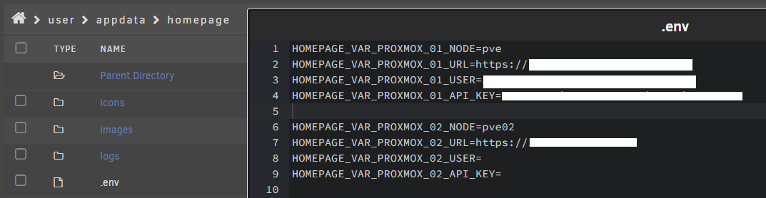

I need to securely store and use API keys and sensitive URLs for my Homepage container, as well as other containers in my environment. According to the Homepage Docker Environment Secrets documentation, I should be able to:
  • Create a .env file in my /mnt/user/appdata/homepage folder
  • Define variables like HOMEPAGE_VAR_APIKEY=my_secret_key
  • Reference them in my config with {{HOMEPAGE_VAR_APIKEY}}
However, these variables aren't being evaluated properly, resulting in non-functional URLs and services.
What I've Already Tried
  • Created a .env file in correct location with proper syntax
  • passed that .env file into the container using a ENV_FILE attribute with a value of  /mnt/user/appdata/homepage/.env
  • Verified file permissions on the .env file
  • Double-checked the variable reference syntax in my config files
  • Searched container logs for any environment variable errors
  • adding a extra parameter to the container of --env-file /mnt/user/appdata/homepage/.env
This is all you need to do, but you need to restart... or possibly force update (rebuild) the container for the envs to stick.
note: I've explicitly stated /mnt/cache, but /mnt/user is fine.
Edited by tjb_altf4
Ooh, I think you may be right... though I have not yet been able to get this rebuild to work. I am about to remove and reinstall and see where that gets me.
3 hours ago, tjb_altf4 said:
Alllright, so I think what I already had did work - or should have. I nuked and reinstalled Homepage and my same --env-file /mnt/cache/appdata/homepage/.env extra parameter, as you described, worked.
At first I thought I was missing an equal sign, eg. --env-file=/mnt/cache/appdata/homepage/.env - but that did not seem to make the difference.
I am still not certain what specifically prevented my previous setup from working, however, I can confirm that Homepage is respecting my environment variables from a .env at /mnt/cache/appdata/homepage/.env
Anyways, thanks!
I have tried restarting, removing the image and reinstalling (rebuilding) - I can get this to work for SOME services but not all.  I'm mainly just using the env variables for passwords and API keys.  I'm getting API data for Plex and two Piholes.  It's not pulling it in for Portainer or Proxmox nodes I have running (I am able to get the data when the PW/key is hardcoded in the services.yaml file).
What is the expected behavior? Do you need to just rebuild one time so Homepage uses the .env file and then you can just add variables to it and it will see them dynamically?  Or would I have to restart Homepage each time I add a new variable? Or would I need to REBUILD each time I add a new variable? Is there some sort of cache storing things so the updated keys take a while to work?
I'm just at a loss why some key variables from the .env file work and some do not. I have allowed tired with/without single and double quotes around the keys with special characters, to no avail. (Notably, one PW with a ! in it works fine without any quotes around it.)
