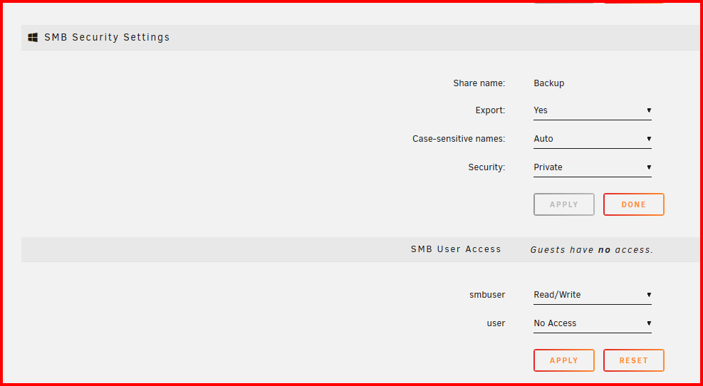

IF you set the security to Private for a share, you have to grant access to that share by setting the permission for each user.  Example below:

Both of the "M" shares were 'Public' in your your first Diagnostics file but the M-----------e share was 'Private' in the second Diagnostics file.  That share also had an indication that you  had assigned read-write permissions to one of the Share Access users.  Did you set up a Windows Credential (in Windows Credential Manager) for that Share Access user.  You also have to reboot the Windows machine any time you make a change to SMB on that computer.

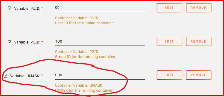

Add UMASK variable to the Docker container.
You may have to click on 'Show more settings" to see the PUID and PGID ones.
The reason for this is that many Linux distributions set the permissions as 755 for directories and 644 for files.  Unraid requires that the permissions be 777 and 666 respectfully.  A UMASK of 000 forces the proper permissions.
OK! Docker run now says:
-e HOST_HOSTNAME="Tower"
  -e HOST_CONTAINERNAME="Sonarr"
  -e 'PUID'='99'
  -e 'PGID'='100'
  -e 'UMASK'='000'
Thinking now this is the permanent fix and will prevent issue going forward? Or is there more to do? (other than updating my other 'arrs' container)
