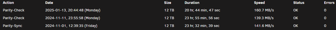

This is how it is going so far:
And this is my history with my current setup:
(on the parity sync - that's where I added 2x12TB drives and replaced the parity drive from 10TB to 12TB)

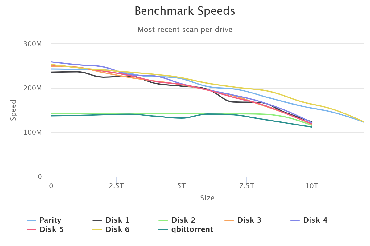

I have downloaded from App store Diskspeed and proceeded to thest the HDDs in my system and the results are ok.
They all pass the SMART tests, all show as expected speeds and when downloading something from the array the speeds are ok and consistent.
