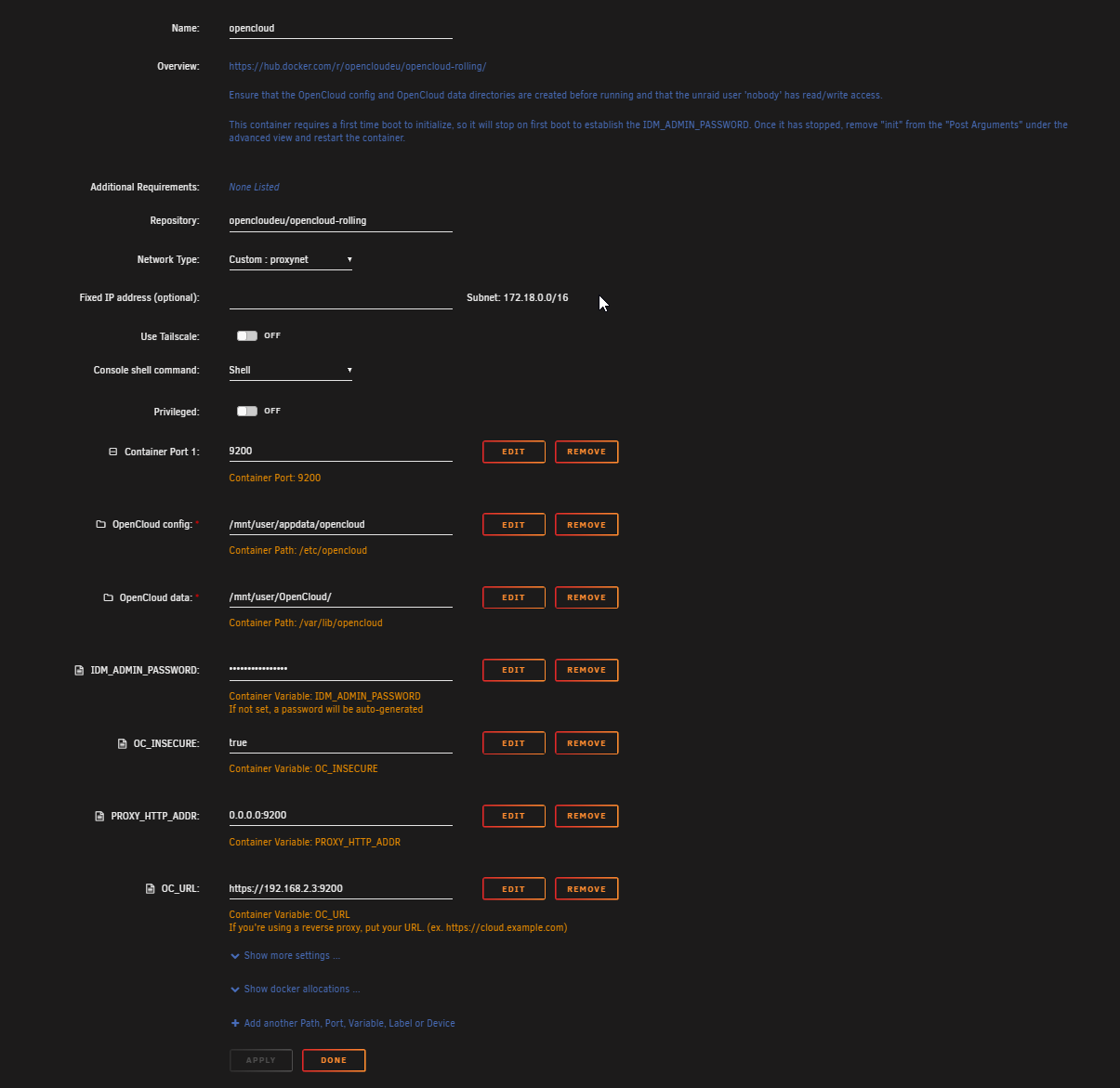

    Hey, regarding the tag issue. One of the devs communicated this morning as follows: Important: We fixed the `latest` tag on the opencloud-rolling image, both on docker hub and quay.io
  • ericwaetke
    ericwaetke
    Alright, took another look into the docs. I’ve chown’ed the config and data folder now to 1000:1000, which works. (Even though the gid and uid in Unraids Settings are 99 and 100, I really don’t unders
Thanks for the app, I have tried to install it, but without success. Its probably me being dense but I followed the instructions can confirm the permissions are set for "nobody" user, and am still getting this error. What is the way to fix this? Should I drop in a blank config.json?
Edit 1:So i did a quick google: turns out in the template adding the port number is required for OC_URL to be able to connect and load the login page. However  new issue is I cannot edit the password.
I get the following error X-Request-Id: 6369e2c6-f5d9-4750-9d5f-8ccc1bb2b880
edit2: I cannot connect via a ngnix proxy manager reverse proxy it displays the error message about a missing config below. Local connection works
edit3: not sure what really changed but i redid the whole thing and I now I can see it on the internet, but its giving me a HTTP 500 error on the login page.
Edited by korefuji
Same problem here.... also with the other repo. Looks like the proxy is not correct (and I do not have any reverse proxy)
I was able to get this running behind a caddy service running on my router.   it needs SSL to avoid the JSON config error.   That said it was incredibly unstable.   Copying files into opencloud caused some FUSE level hangs that locked up my unraid and forced me to physically turn off the server.   Keeping an eye on the project, because I need a skinnier alternative to nextcloud, but want to let it bake a bit more.

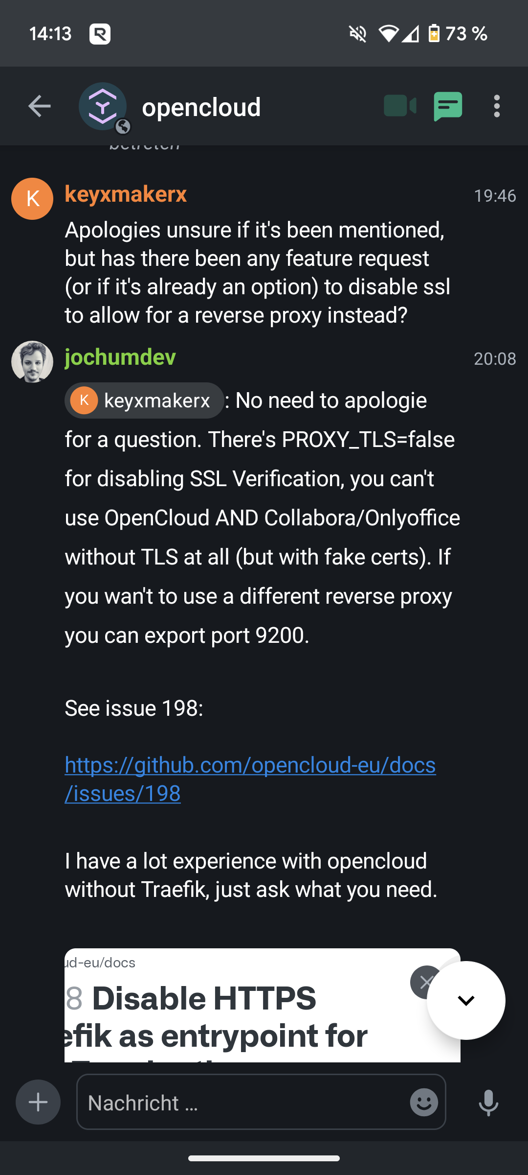

it works via web, but when i try to sign in via Windows Client from the Windows Store, i get a 403 forbidden.
I use NPM for the subdomain and the SSL Zertificate.
Any suggestions?

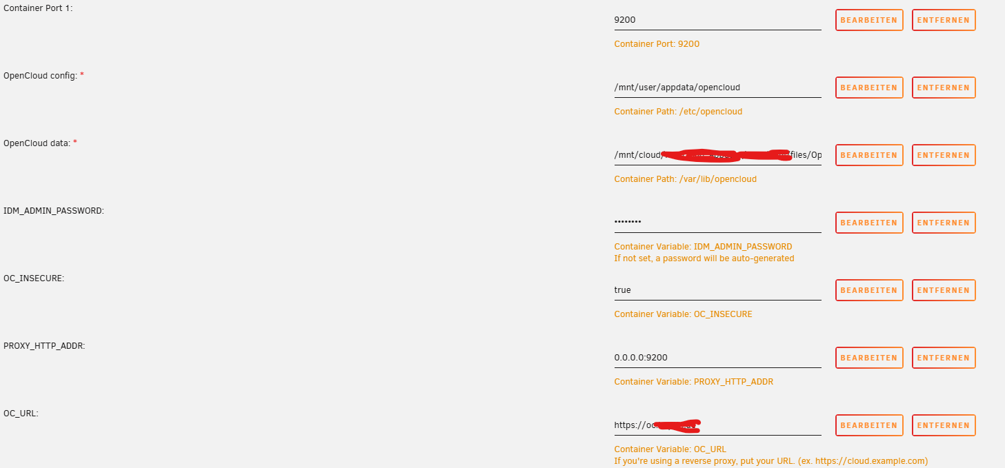

Hey guys, I also had some trouble with the config.json error message. I tried it several times with several permissions (751, 755, 777) and owner (root, UID1000, nobody). Nothing helped. I wanted to ask within the element support channel but before I had a look onto GitHub. There is an closed issue existing. Beside all the known tipps and tricks I set "OC_INSECURE"=true
Than I was able to get on the login page by typing Https://IP:9200
After installation take a look into the container log file. If there is any issue, repeat it with a clean installation. During initialisation I only had got the message, that the config was successfully created and my login credentials.
After starting the container again without "init" I got no error and no warning or whatever within the log. Than it ran.
One last point: set in any case a new password. Each time I kept the standard I ran into some kind of error.

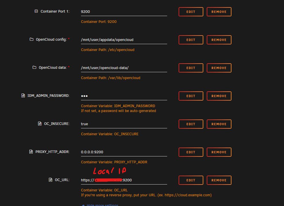

Hello after installing my config was succedfully created with this unraid settings:
But when I Try to access it cia https://IP:9200 I get this:
When I set OC_INSECURE to false and acces via OC_URL, i'm getting this:
What could be the issue?
Log is this atm:
{"level":"error","service":"idm","bind_dn":"uid=idp,ou=sysusers,o=libregraph-idm","op":"bind","remote_addr":"127.0.0.1:52536","time":"2025-04-28T12:27:09Z","message":"invalid credentials"}
{"level":"error","service":"idp","error":"ldap identifier backend logon connect error: LDAP Result Code 49 \"Invalid Credentials\": ","time":"2025-04-28T12:27:09Z","message":"identifier failed to logon with backend"}
{"level":"error","service":"storage-system","pkg":"rgrpc","traceid":"25eb97835d21243cf4ce290b6681a2b9","error":"error: not found: space jsoncs3-public-share-manager-metadata not found","status":{"code":6,"message":"not found when listing spaces","trace":"25eb97835d21243cf4ce290b6681a2b9"},"filters":[{"type":2,"Term":{"Id":{"opaque_id":"jsoncs3-public-share-manager-metadata!jsoncs3-public-share-manager-metadata"}}}],"time":"2025-04-28T12:27:46Z","message":"failed to list storage spaces"}
{"level":"error","service":"storage-system","pkg":"rgrpc","traceid":"fbae28a1460909d358f55b48e4cbba82","error":"error: not found: space jsoncs3-public-share-manager-metadata not found","status":{"code":6,"message":"not found when listing spaces","trace":"fbae28a1460909d358f55b48e4cbba82"},"filters":[{"type":2,"Term":{"Id":{"opaque_id":"jsoncs3-public-share-manager-metadata!jsoncs3-public-share-manager-metadata"}}}],"time":"2025-04-28T12:28:46Z","message":"failed to list storage spaces"}
Any suggestions?
I also haven't quite figured out how to get the windows desktop client working. This project is still very young and I don't believe the rolling-release is "fully baked". In their docs they have a docker-compose setup which seems to be "batteries included". I haven't had the time to sit down and see what all is needed for the rolling release.
Can you post what you have in your template?

Do you have a reverse proxy you're using? If you put it behind it, are you able to access?

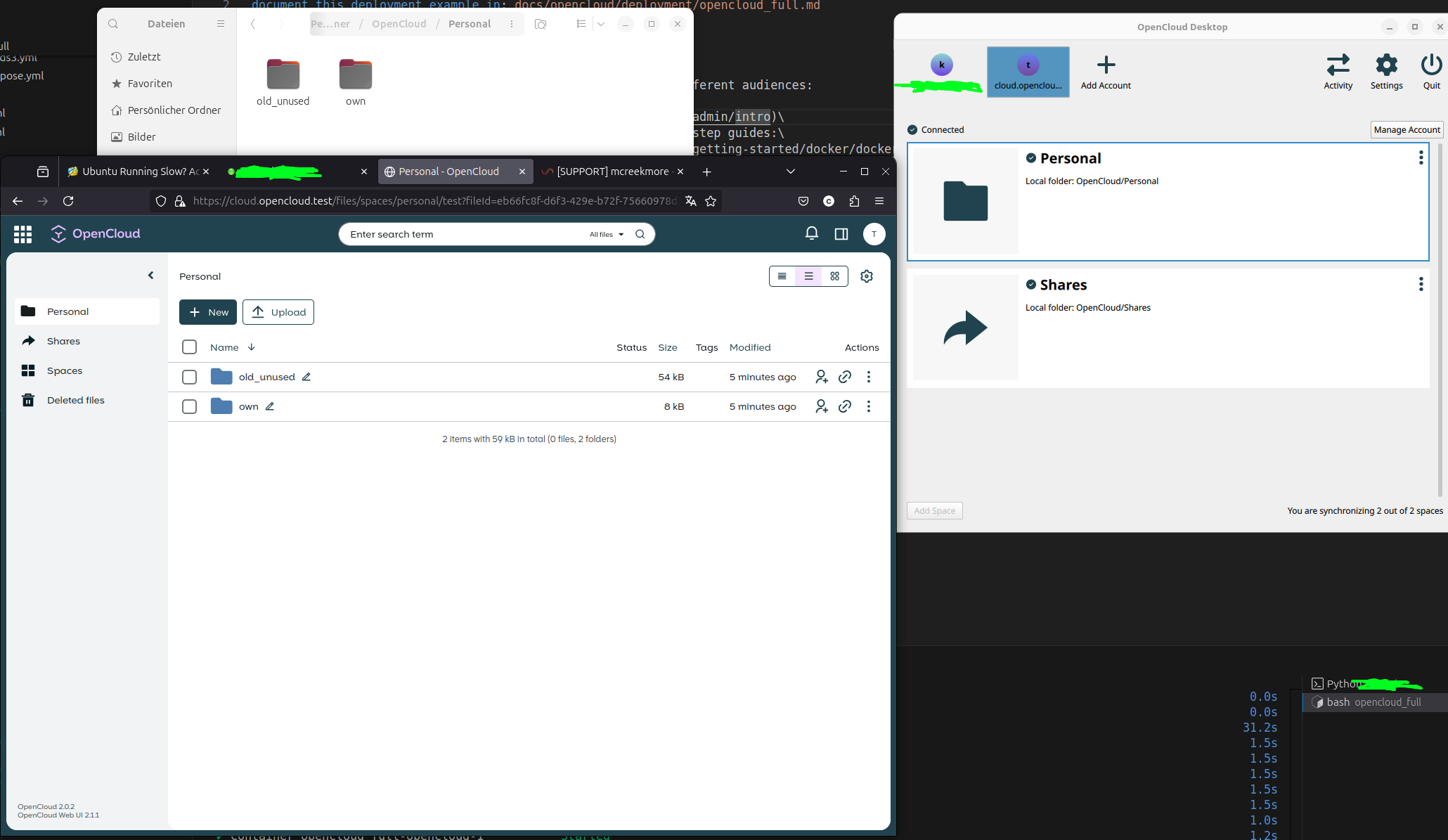

Regarding the desktop app. Until know Opencloud only created the folders within my destination location. But they are all empty. The connection allways timed out after starting syncing. I will look if there is any permission issue.
I also want to check whether this error occurs in the linux app. For now I just tried it in Win 11.

I tried it out locally before I tested your solution. It ran without issues from the beginning. But unfortunately this will start 3 different services. But all the collabora stuff is not needed for my usecase. Thus I took no further effort into this.
However, as far as I understood, the opencloud-eu rolling docker should be enough for the cloud service.

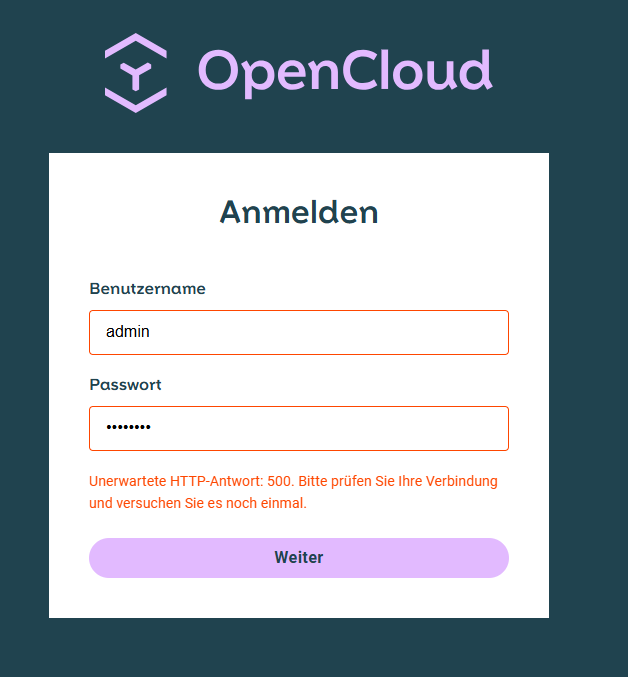

To connect the WindowsClient from the WindowsStore, i needed to disable
"Block Common Exploits" in my nginx proxy manager.
But if i try to sync somthing i get 500 and 504 server errors.
Maybe this could help?

On 5/1/2025 at 12:15 AM, mcreekmore said:
Are you saying you were able to connect to the windows 11 desktop app with the local docker-compose setup?
I just figured it out.. OC (docker compose variant) runs fine with Ubuntu. Everything worked proper (WebUI, desktop app, sync).
But with win 11 I could not find a way to establish a connection. TBH I did not spend so much time but I followed the instructions, I tried a couple of ports and IP's, I deactivated the firewall. Nothing helped. Maybe some issue with WSL?! I do not know.
Anyway, I could reach my server with the app via Port 9200. But for now no single file have been syncronized. Next to this, the connection is really unstable. At the real beginning I thought it could be a permission failure. But for now I think this behavior is caused by the app and or the container.
I think the app needs some more time. Lets wait for the next version.
