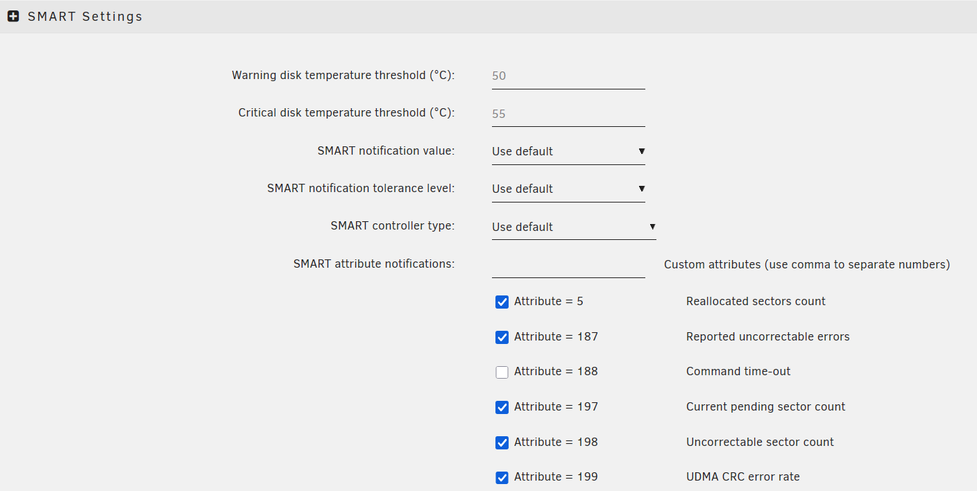

This is what I can see in the Disk3 SMART settings in the GUI, if that's any use.

The only reason I mentioned serial numbers is the slight possibility (perhaps even mythical) of a bad batch of disks from the manufacturer. But SMART looks OK.

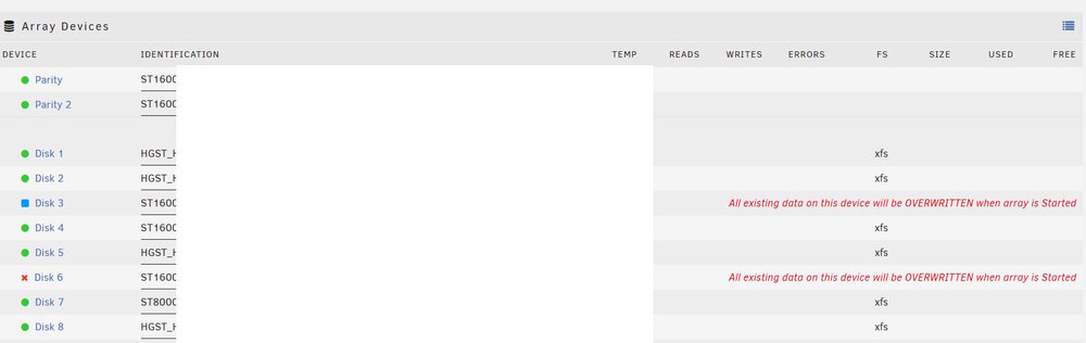

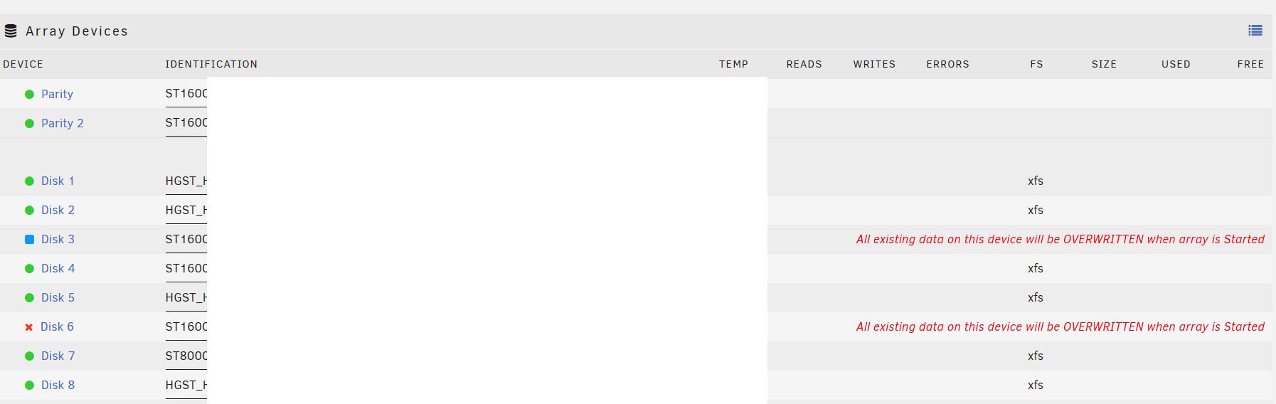

I'm now trying to rebuild Disk 3 onto itself, but I get this warning message for both Disk 3 (understandable) and my disabled Disk 6:
"All existing data on this device will be OVERWRITTEN when array is Started".
What's going to happen to my Disk 6 data? Not going to proceed for now.
Since that disk is disabled it would also be rebuilt.
But I didn't go through the stop/unassign/start/stop/reassign process for Disk 6. So unRAID will just rebuild both at the same time? I had thought unRAID would be more conservative - as in one rebuild at a time. But I suppose there's no real additional risk.
So I can just go ahead?
In that case, it should not rebuild, possibly the warning is wrong, you can also unassign the disk to make sure, and should do that first if you haven't confirmed the emulated disk is mounting and contents look correct, but if it all looks good, might as well try to rebuild both at the same time, no increased risk, since they are already both disabled.
Just confirmed, it's a bug.
The diagnostics posted Sunday indicated both emulated disks were mountable
Thanks, yes, I'm now rebuilding Disk 3 and Disk 6 stays emulated. A bit of an edge case, so not many users are likely to see the two messages.
