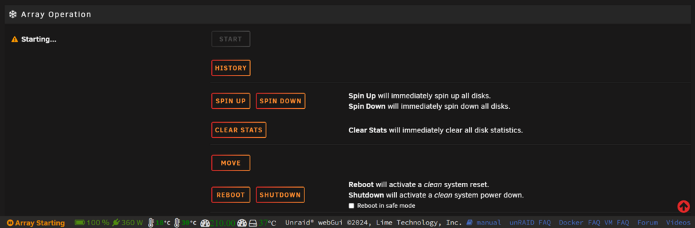

[HELP] After Rebooting a working server... stuck at array starting and nothing happens
After Rebooting a working server... stuck at array starting and nothing happens.
Everything was fine before reboot. Restarted multiple times, no dice.
UI is responsive but the system is stuck

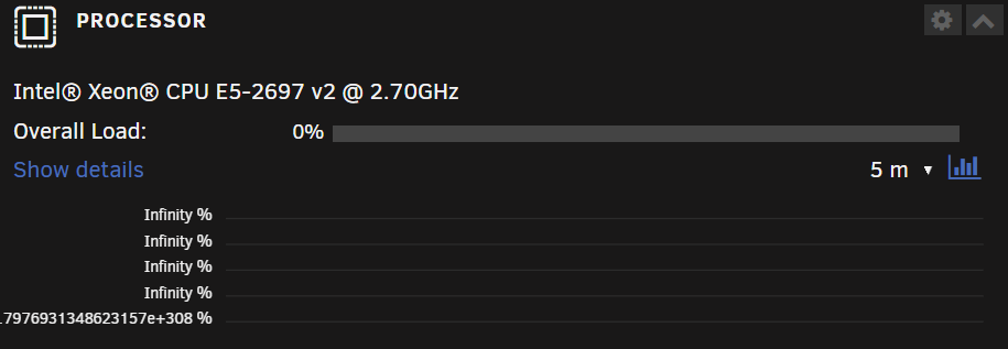

Dashboard shows no CPU data

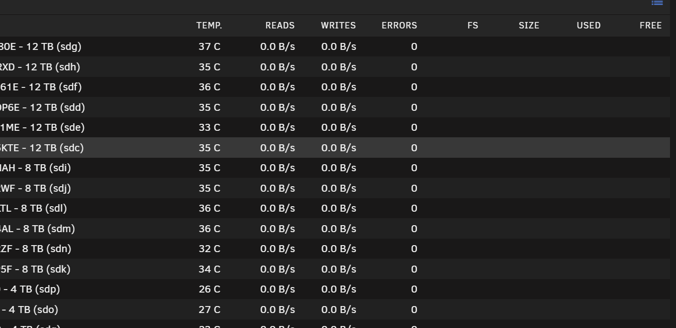

Here is how the drives show without size and used/free data:

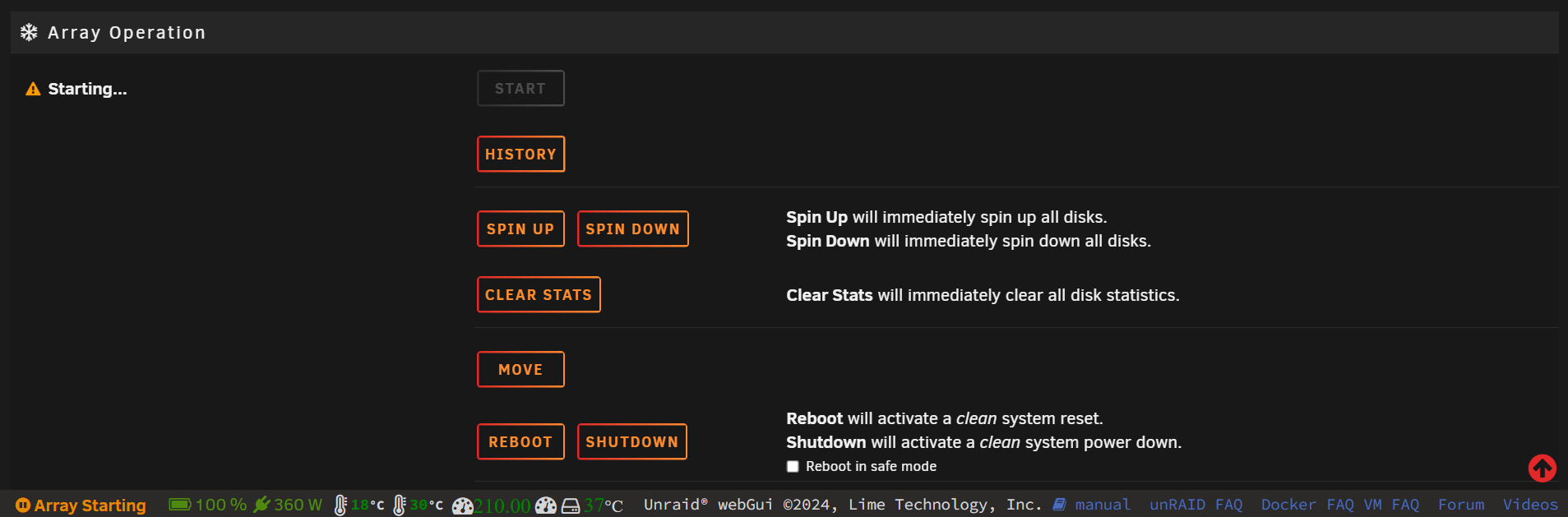

The Array operations is stuck:
Running UNRAID v6.12.15 on Dell R720xd
