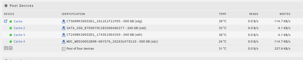

I have a cache pool with 4 drives (2 x 240 GB and 2 x 500 GB) in it using BTRFS in RAID 1. I have 2 new 1TB drives, and want to replace the 4 existing ones.
I can see that I can replace 1 drive at a time in the pool and letting the system rebuild after each replacement using the GUI, and I then end up with the 2 new drives, as well as 2 of the old drives.

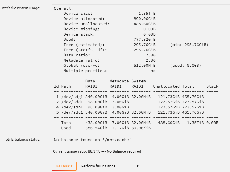

I'm then not sure exactly how to remove the remaining 2 drives. Do i:
  1. Remove 1 of them, balance /  let it rebuild, then remove the last? This is in the manual here, as long as metadata is turned on (which I think I have - see screenshot below).
  2. Use the CLE methos as described in the manual here, which I'd prefer not to do if I can help it.

I think I have metadata turned on in RAID 1:
Solved by JorgeB
There's an issue with Btrfs raid1 pool removal in 7.0.x, it should be fixed for 7.0.2, but for now, you would need to use the CLI to remove the devices, those linked instructions will work, except the part to reimport the pool, for v7.0 use this instead, this would be to reimport with just the two remaining devices:

Hi @JorgeB,
So I've been away from my server for a few weeks, and now back and ready to proceed, albeit a little nervous! I think I've mapped out all the steps needed, in sequence, using the drive info for my cache as set up in the image below:
Steps to Follow (combination of your instructions above and the linked Docs):
