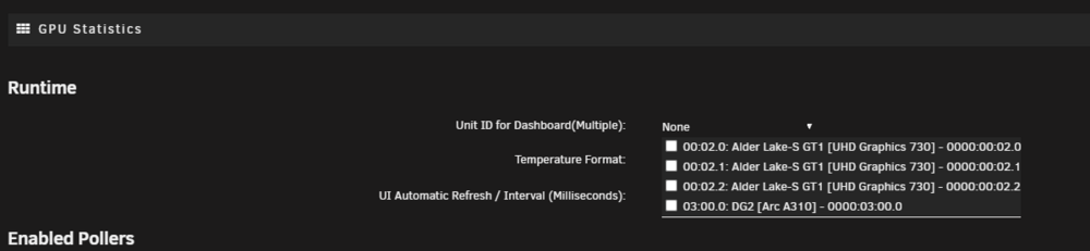

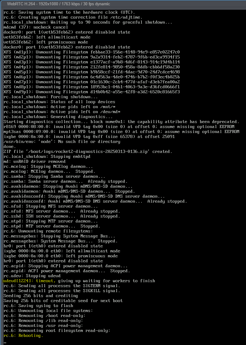

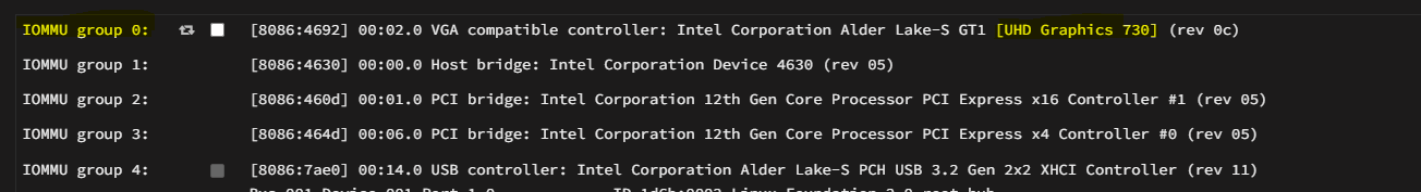

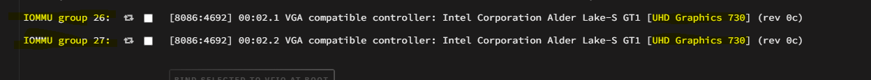

Fast forward to last night, automated bootup and then shutdown (informed via notifications) however I see via home assistant that the backup server is still pulling ~160w (normal full power) I log into KVM and see unraid was working on shutting down, but never did. Had to do a hard shutdown. Boot back up and it was an unusually long time before I can log in (5 min after it displays the ip + log in via command line) once I logged in the array take a substantial time to start as well. shutdown / reboot ends up with the same result of never actually completing the shutdown process. I updated to the latest version of unraid, no change. right away I noticed something new... in system devices, the iGPU on my processor shows up with 3 devices. never seen that before.
I removed the A310 and booted, 100% normal boot up time, operation and shutdown, however the iGPU still shows up as 3 devices. is this my issue?
Either way, install the A310... back to long bootup and array start and will not shut down normally.
I included the diag data... not sure what to do here. I know having the A310 installed causes my issues... however I know that should not be. I also know the iGPU should not show up as 3 devices either (my main server 13900K does not show the iGPU 3 times... just once.

image.thumb.png.d07c81b9fc77fb109995e493053c1bc3.pngimage.thumb.png.be823005b716ef5e21bc8fe3e1749e18.pngimage.thumb.png.d1b12947445f8e64e7ceab5ebfe6f841.png
On who do we pin the responsibility for installing sr-iov? Raccons, ghost or aliens?^^
But thats not your issue. Although removing sr-iov might be worth giving a shot, since it brings it own drivers

Well that was a silly rabbit hole...  went after updating the bios and then the computer would not POST.... solid black screen. removed the bios battery, RAM and Re-seated the HBA + 10GB NIC.... put all back in and boots fine and now I am back to 1 iGPU device listed. install the A310.. and everything is fine now. WTF. I have to assume something with the Bios update and re-seating everything was responsible.
