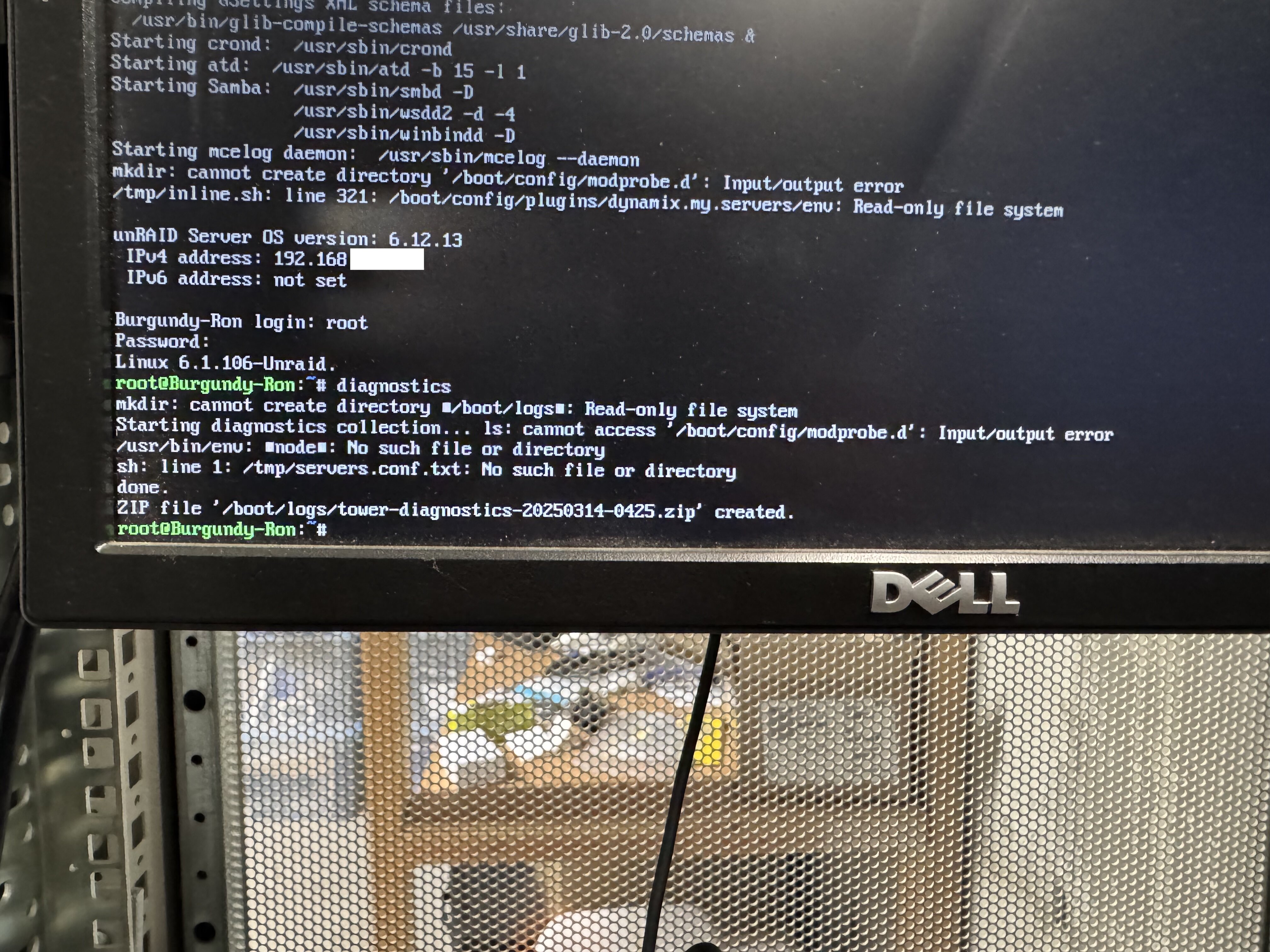

I jumped into the USB and I don't see a /boot/logs folder or a diagnostics.zip file but I took this picture off the screen. I had a EFI/boot/ but there were no zip in it. I look through the USB on both a mac and pc and didn't see the folders.
There should be a /logs folder, not /boot/logs, and the diags should be there.

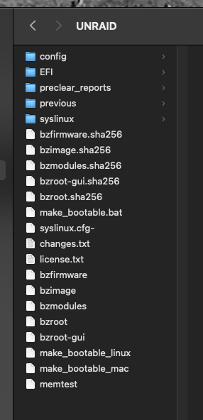

This is all I have when I open the USB.

Sorry, completely missed this line:
Flash is read-only, first try recreating the flash drive, backup the current one, then recreate it using the USB tool, confirm the flash drive boots with the stock install, and if yes, restore only the /config folder from the backup overwriting any existing files.
