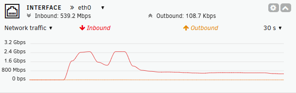

Hi all, does anyone here have 2.5Gbe working well in unraid?  I have 2.5G Nic's and 2.5G switch.  When i copy a file from desktop box with a 2.5G nic over to the unraid server that also has a 2.5G nic the file transfer starts off fast at ~280MB/s but then quickly plumits down to ~60MB/s.  What settings am i missing to have this file transfer stay closer to the ~280MB/s and remain at that speed for the entire transfer?

That looks like you are being limited by the device/pool write speed, where are you writing to?

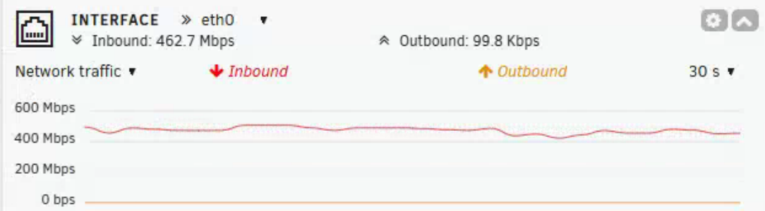

in a test setup i am pulling the data from a sata 2.5" SSD in the windows desktop and writing to the unraid device pool that consists of 1 sata 2.5" ssd for parity and 1 sata ssd for data.

Yeah, does not look very good.
Should be like
"G" instead of "M"...

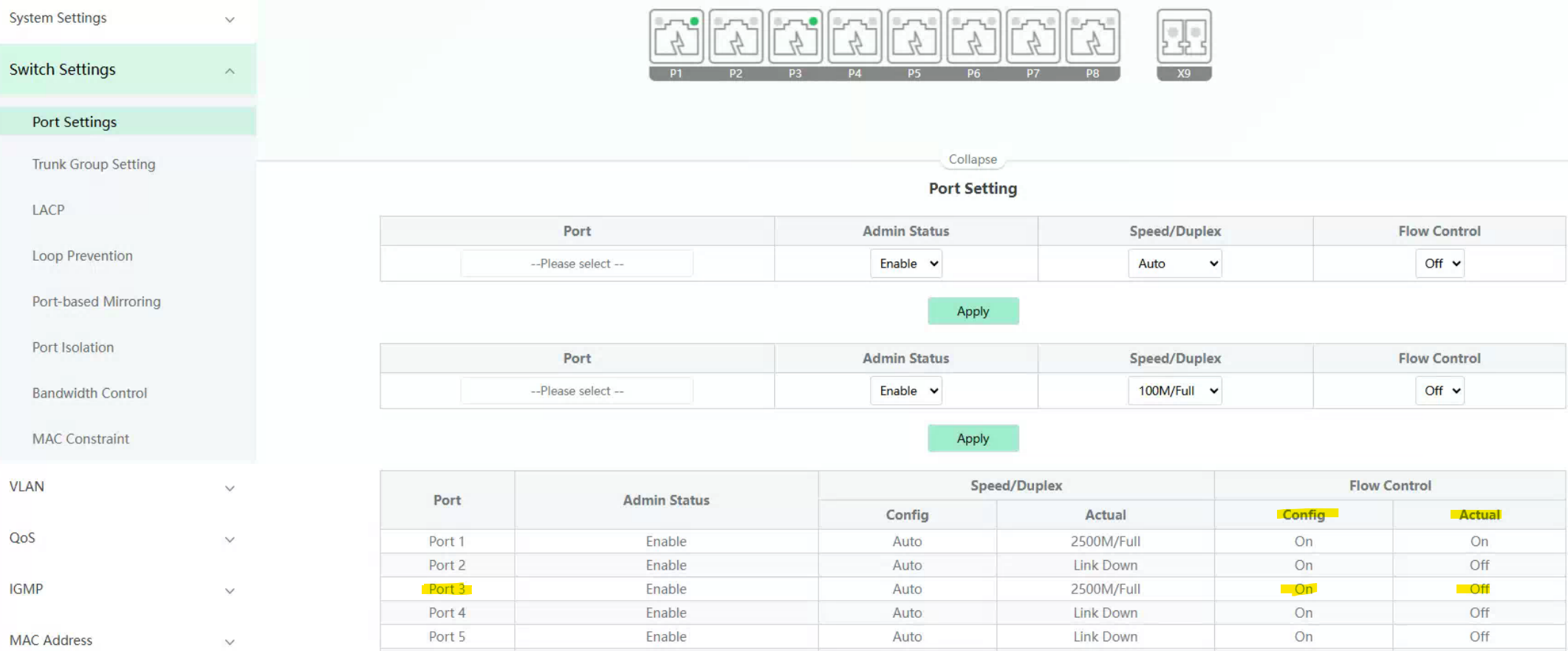

make sure all your attached devices (computers / switches and so on) have turned on "flow control" and are capable of handling it correctly
else I am running out on ideas.
Sorry
does the second highlight mean i cant have flow control on, on any of my NIC's?
no no. all fine. Flow control is ON. Just dont turn it off.
But as I said, all other devices need to support and honor it too.
This is because "2,5G does not exist". It is an "illegal" speed, it uses 10G encodings and speed. Just it introduces "10G with pauses", from 4 different windows it only uses one (to allow recovery for the cable and to allow cheaper and lower quality chips to be sold). Flow control is needed to tell the partner which one is to look at and which three need to be ignored.
(simply spoken, the real encoding stuff is heavily complicated, you would not sleep well anymore if you try to understand it).
So without flow control, they talk but many packets are lost and need to be repeated. This seriously drops the throughput rate.
But your 400mbs? naah, flow control problems would go down to 50-60Mbs...

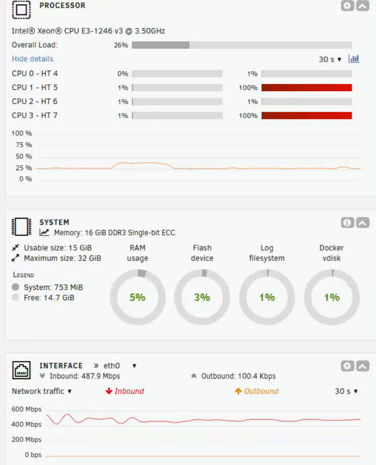

Why is your CPU "glowing" (100% usage) on some cores? Does not sound very good too...

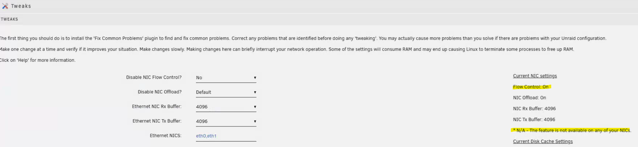

Port 3 in the below screen grab is my unraid server with a TP-Link TX201 in it.  Maybe the driver for this card in linux does not support flow control?
dunno... but at least this screenshot does not look right. You WANT FC but the card does not grant it... danger ahead!
