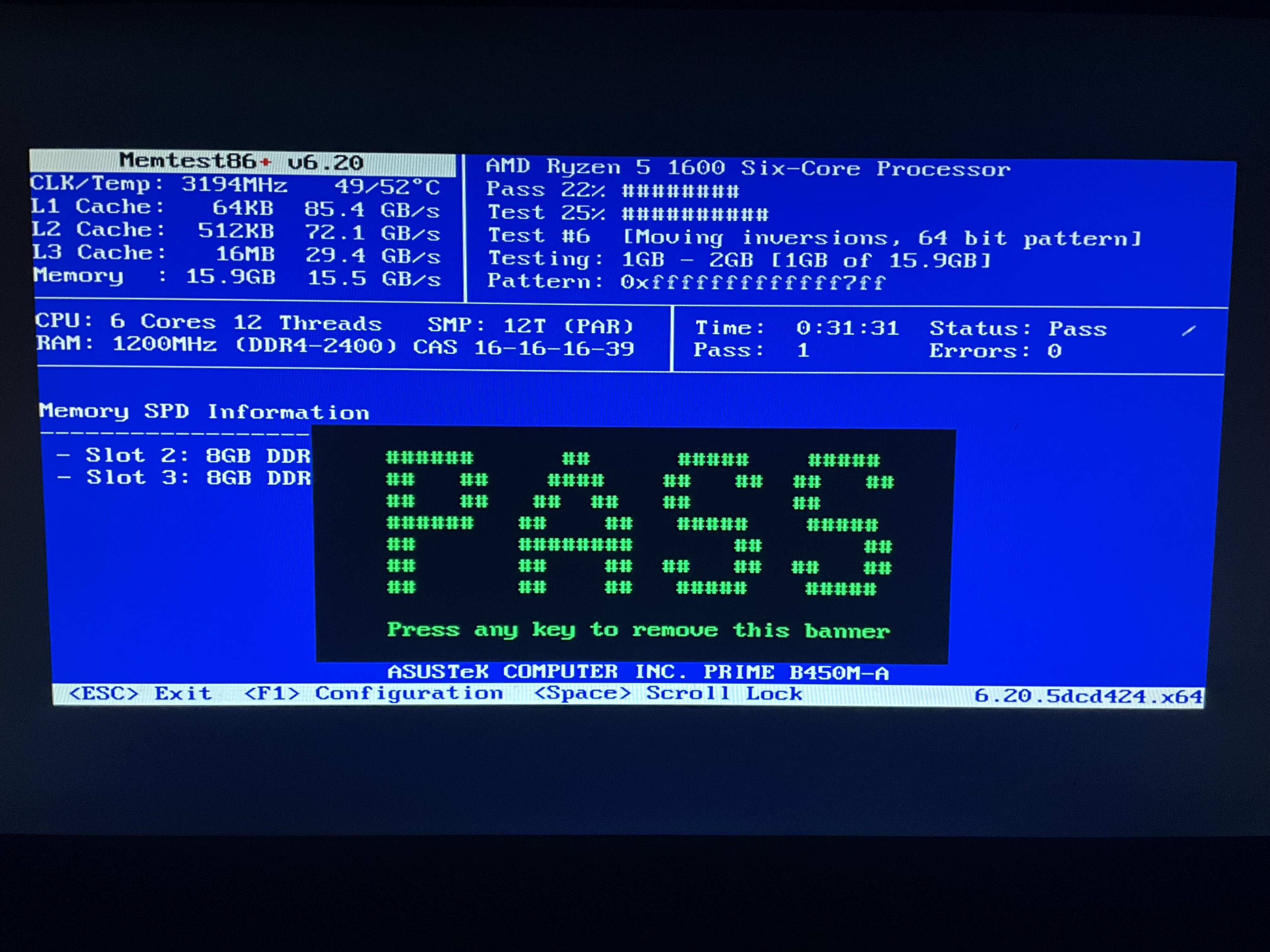

Running memtest now, assumed this was likely a bigger issue than just the Plex docker, as I am having similar issues with all other Docker containers now as well (even trying to delete unneeded ones - I get the error "Execution Error: Server Error".

Memtest appears to have passed, unless I am missing something with this.

memtest failure would be failure. memtest pass isn't really a guarantee but maybe longer run would be more assurance.
