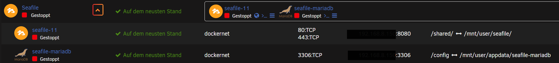

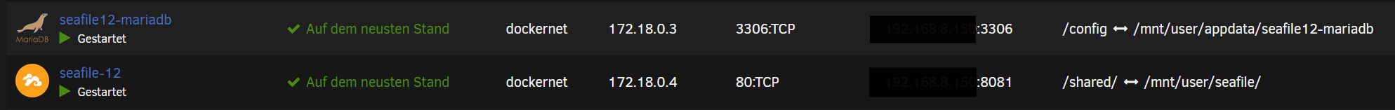

Since I only want to switch once everything works, I stopped the existing Seafile 11 and MariaDB Docker containers and created a new MariaDB instance for Seafile 12.
Accordingly, I named the new container "seafile12-mariadb" and adjusted everything else to match. See screenshots below:

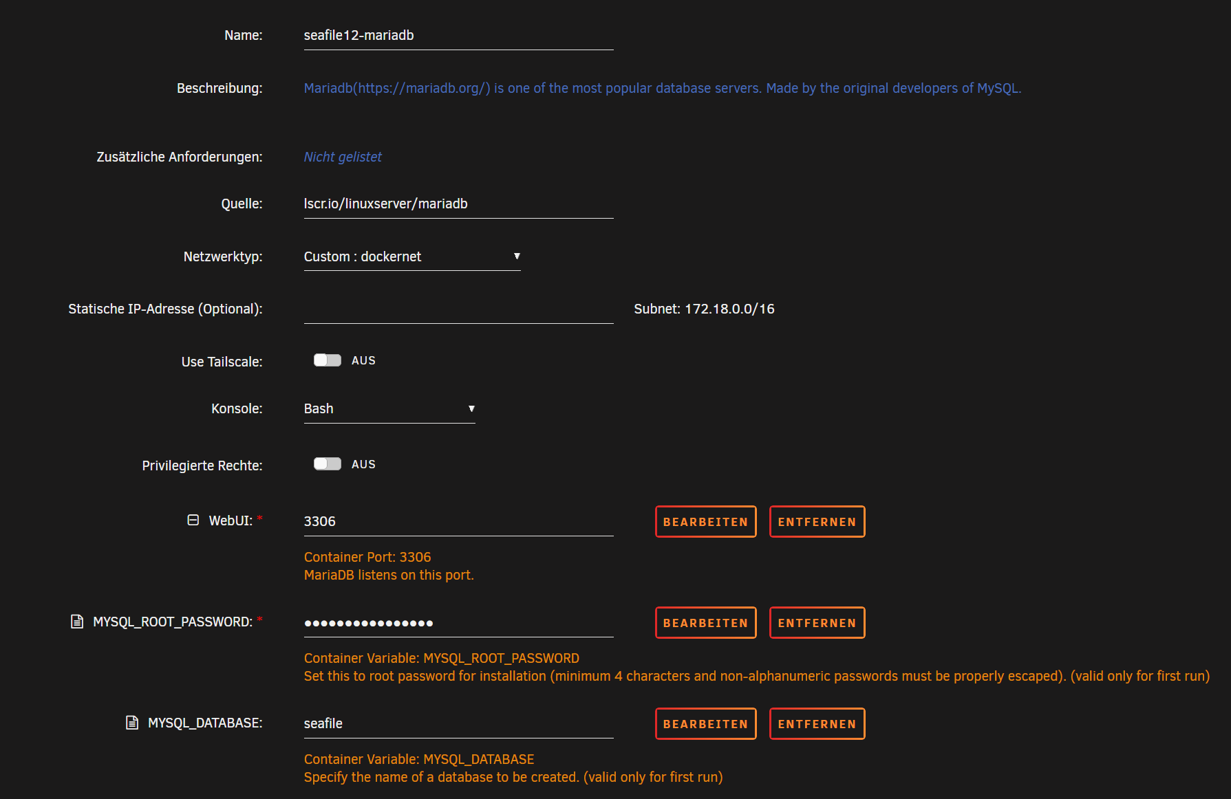

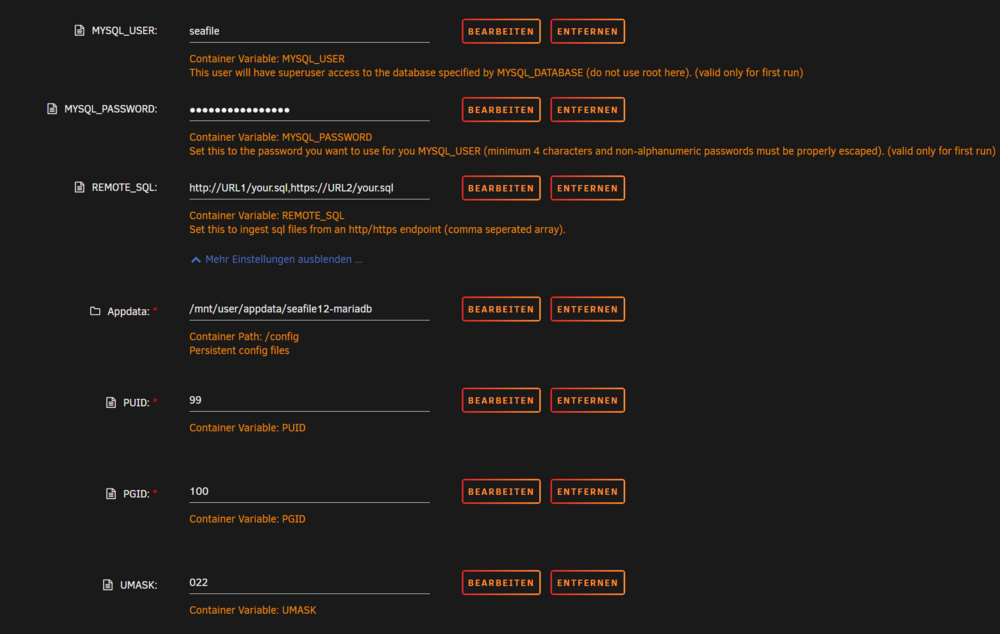

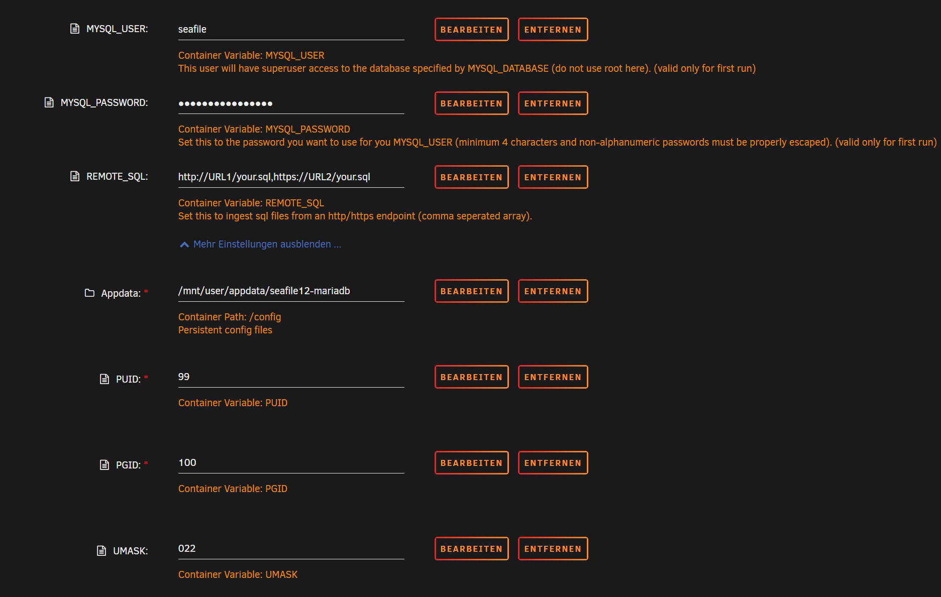

Here are the settings for the MariaDB docker container:

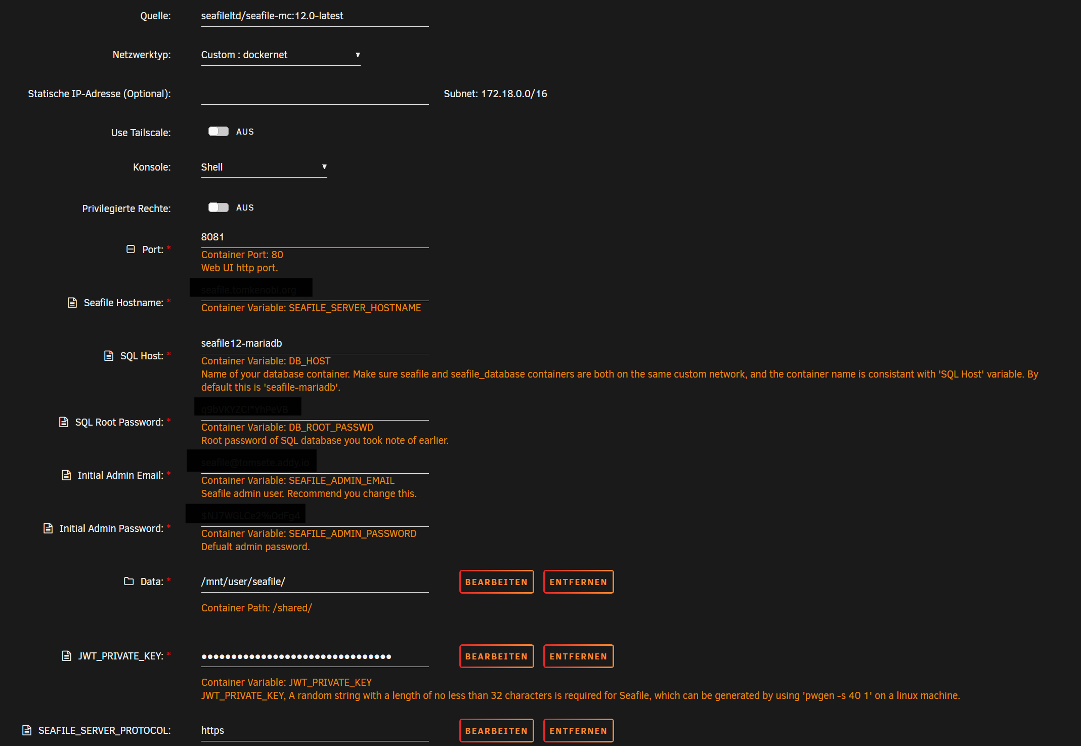

And here the settings for seafile-12 docker container:
By the way, I already had issues with Seafile 11 not working properly with seafile-net, so I used an already existing custom Docker network instead. I did the same thing here.
I’d really appreciate your support with troubleshooting this. I’m sure it’s something on my end, but I just can’t find the solution. Please let me know which additional info or screenshots you might need.
Thanks a lot in advance!

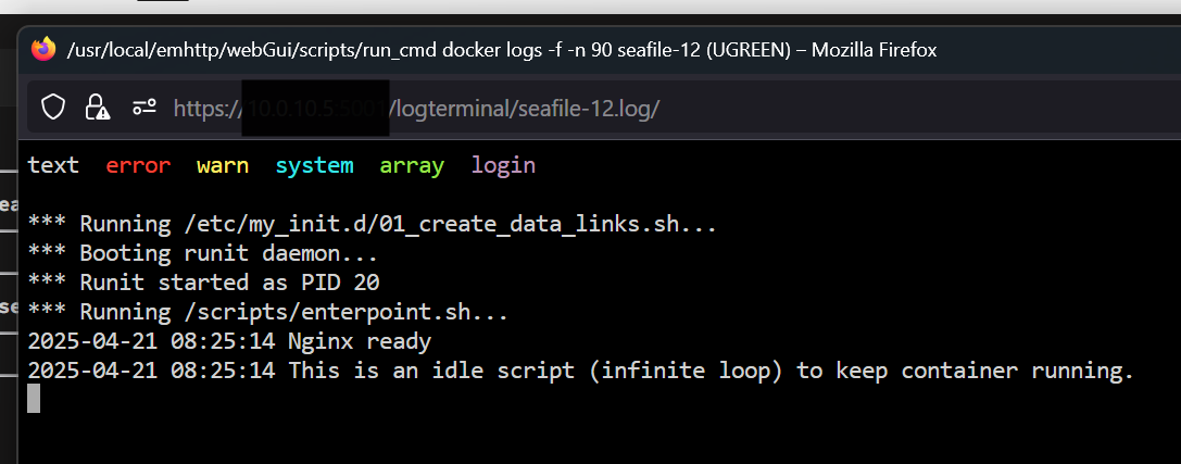

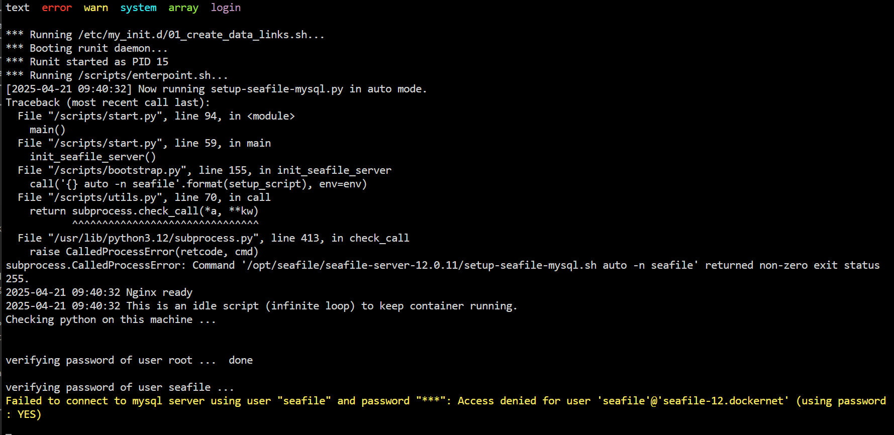

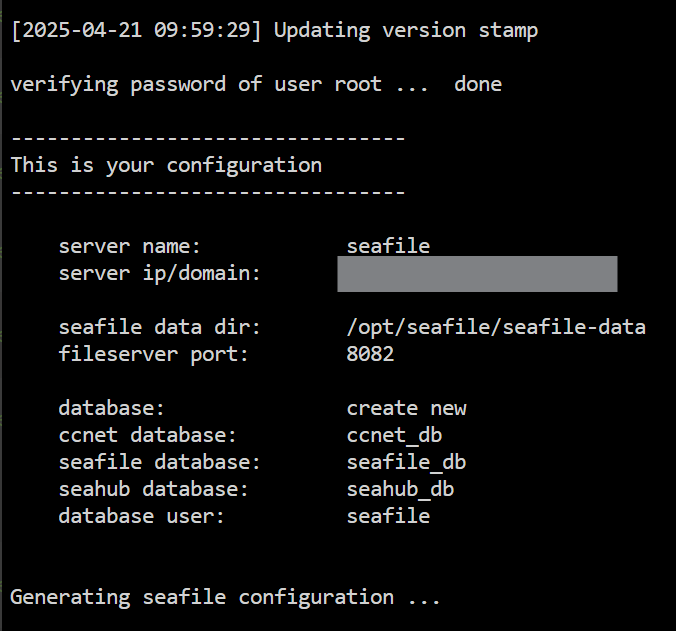

And here's the container log after starting the seafile-12 container:
Edited by tomkenobi
Adding container log
I have now also renamed the SQL from seafile12-mariadb to seafile-mariadb and also renamed the container to seafile-mariadb. Now everything seems to be exactly as it was setup for seafile-11 before. I'm getting this error now when staring the seafile-12 container. Thias also happened before renaming this:

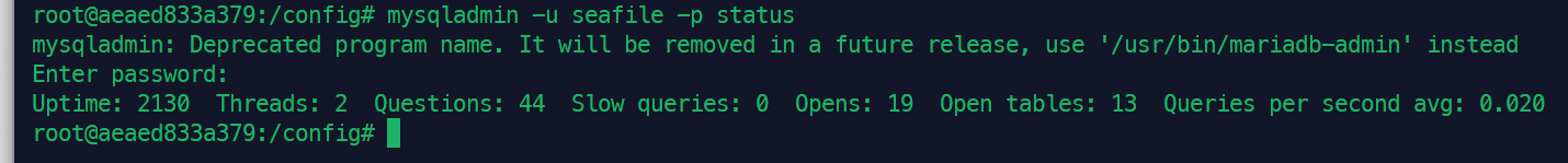

I also tried accessing the db within the container like this:
So the MYSQL_PASSWORD works. I double checked the password (here MYSQL_ROOT_PASSWORD) I set in the settings for the seafile container, matching everything to the previous setup. Don'T know what I'm missing here.

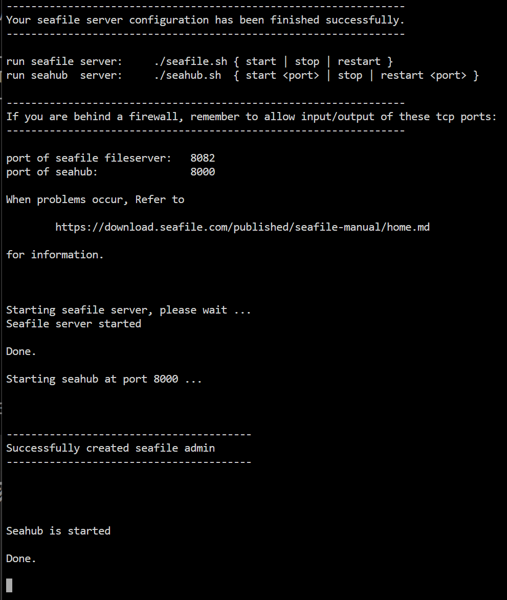

Back again. Now I did what I for sure didn't do when setting up Seafile 11. I went to https://github.com/chirmstream/unraid-templates/blob/main/seafile-12/seafile-12_guide.md and found the following:
Go ahead and remove MYSQL_DATABASE, MYSQL_USER, MYSQL_PASSWORD, and REMOTE_SQL. Seafile will connect to Mariadb with the root password and create all necessary users and databases.

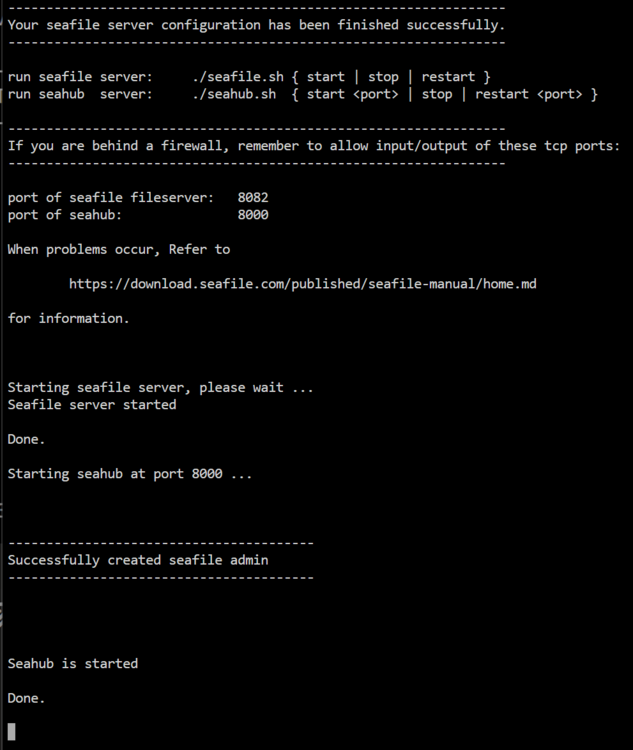

Suddenly I got this (again like in Seafile 11):
I can now move on to the WebUI using either the local IP:8080 (I changed from 8081 to 8080 to make sure this wasn't the problem). I use the same credentials as with Seafile 11. But now there's this message showing up:
So I think I already got quite far till this point.
I'm glad you found my note regarding the database setup.  I've found its much easier to only define the container root password and pass that along to Seafile.  Seafile is smart enough to setup all the database tables and everything on it's own.  I've considered make a mariadb template just for Seafile so that people don't mistakenly fill that stuff out and then give up when it doesn't work, but I think it is 'iffy' on how well that would adhere to the community app store ethos.  They don't want people making a bunch of templates that use the same container.  When you search mariadb there are already a few options so I'm hesitant to add more.

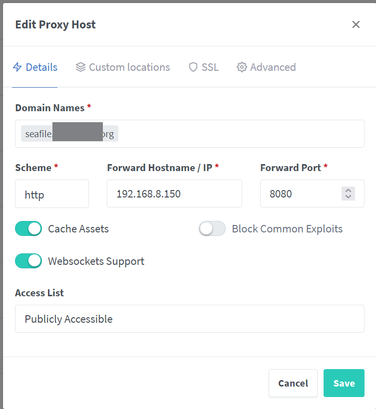

From your logs Seafile is working and configured correctly.  What is your reverse proxy setup?  Can you access seafile over LAN (192.168.xx.xx:8082)?  Double check that your reverse proxy is pointing to the correct port for Seafile (8082 from your logs, template screenshot showed 8081).
Once you get to the webui if If you're having problems uploading files you may need to change "SEAFILE_SERVER_PROTOCOL" to http.  My Seafile server is behind NGINX Proxy Manager with Lets Encrypt SSL certificates generated by the proxy manager.  I had issues uploading files until I set "SEAFILE_SERVER_PROTOCOL" to https.  I made that the default setting for the template because I believe this is how most people will setup their server, but if yours is different you might have to change it.

The Seafile WebUI is reachable both locally over LAN and via a FQDN with https. I’m using NGINX Proxy Manager as well, and everything seems to be configured correctly there. I changed the forward port in the docker container to 8080. MariaDB ist also set to standard 3306. However, after entering the username and password on the login page, I can’t get any further.
At some point I briefly tried setting SEAFILE_SERVER_PROTOCOL to http, but that didn’t change anything – though it’s possible something else wasn’t right at the time. I’ll test it again with that setting and report back once I’ve tried it.

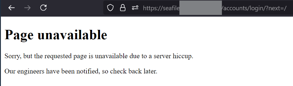

I installed MariaDB with just the MYSQL_ROOT_PASSWORD set, and installed Seafile 12 exactly according to the instructions.
I always made it successfully to the login page — both locally and through the FQDN set up in NGINX Proxy Manager.
However, every time I try to log in, I end up on the following error page:
Page unavailable
Sorry, but the requested page is unavailable due to a server hiccup.
Our engineers have been notified, so check back later.
I have no idea what is causing this. I also tried going from https in the container settings to http. The Seafile container log right after deployment shows no errors. Maybe I need to make some adjustments in seafile.conf or seahub_settings.py. I vaguely remember that during my very first attempts with Seafile 11, I had to change something there to make it work.
Since I'm heading out on a weekend trip in less than two hours, I'll leave it as it is for now. Maybe I'll get another chance to experiment with it on Monday.

4 hours ago, tomkenobi said:
Page unavailable
Same issue with me, as soon as I log in I get that same error page.
