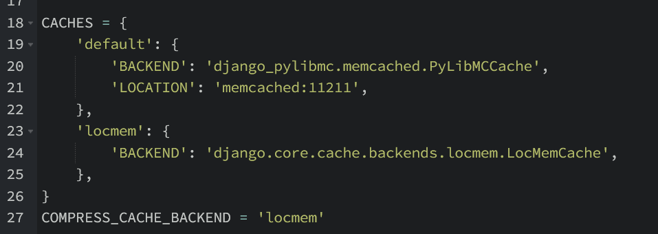

@tomkenobi I got seafile 12 working, you need to download and install the memcached docker container by A75G and add it to the seafile custom docker network you created.
Or if you don't want to install memcached in a docker you can just edit the seahub_settings.py and change this
CACHES = {
    'default': {
        'BACKEND': 'django_pylibmc.memcached.PyLibMCCache',
        'LOCATION': 'memcached:11211',
to this
CACHES = {
    'default': {
        'LOCATION': 'localhost:11211',
Also, if you run into the issue I did where the admin account will not let you login, you need to get into the container console and run the reset-admin.sh script and set the admin email and password. Located in the /seafile-server-latest/ directory.
You should be able to login after that.

Now that the admin login is fixed im going to test out a fresh install to see if the memcached thing is still an issue. Ive removed as well to test.
Test complete: it appears it was just the admin email/password issue, not memcached.
Edit 2: However, if memcached is not configured, instead of getting the "Invalid Login" page, the user is instead presented with the "Page Unavailable" screen. This would explain the behavior I expereinced because I could not login due the admin/password bug.
The two options to remedy this are to either install memcached and add it to the seafile-net docker network OR to remove the CACHES {} portion from the seahub_settings.py (setting it to localhost does not fix it)
Edited by MowMdown

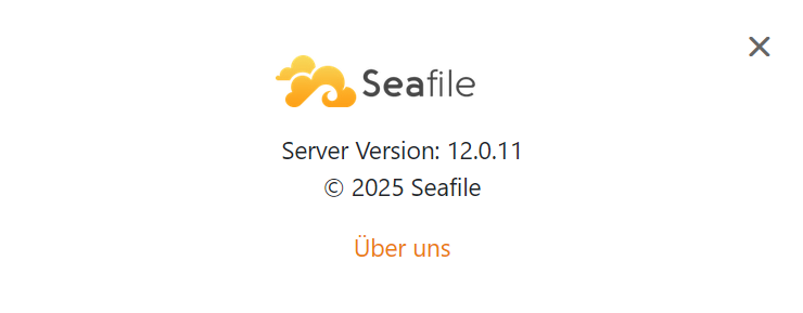

Thanks for following up @MowMdown — and you're right about the versioning point in Filerun, credit where it's due.

Just to recap the events and issues:
1. The first run admin credentials issue was fixed, this allows the user to login with the supplied credentials. Previously this was not possible.
2. The memcached docker requirements IS still an issue. If memcached is not installed or part of the seafile-net custom docker network you will get "Page Unavailable" errors if you do any action in which may throw an error. For example, log in with the wrong credentials.
To fix the #2 issue the user either needs to remove the CACHES{} backend from the seahub_settings.py config file OR install memcached and include it in the seafile-net docker network.

I've now installed memcached, and it works as expected — even when entering incorrect login credentials. Thanks a lot for your help @MowMdown!
As you mentioned, changing the seahub_settings.py to use memcached > localhost didn’t work for me either. But I didn’t go any further trying to remove the entire block — since everything is working fine now with memcached running.

After testing out
I’ve now switched back to the Community Edition. I followed the guide by @dglb99, and the log shows the following:
So it looks like everything worked I guess. Search is now functioning again within the libraries.

Hi all!
Just a quick screenshot from the OnlyOffice log, as I remember to have something similar. Se here:
But everythings works. I can edit all types of files, they get locked in Seafile during this, I can all save them. Also on my phone. So this is probably not a big deal. At least for me as I do not understand this log. Maybe someone can help me out. But it works.
Regarding reverse proxy I use Nginx Proxy Manager. So I can't say anything about Swag.
