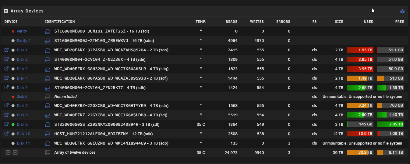

- My current situation is Parity disk 1 is disabled for unknown reasons, data disk 6 is physically out of the array, data disk 11 is in the array but shows as unmountable. I'm adding a screenshot for the visual ones out there (like me)

My thoughts - Could I somehow enable the parity disk again and rebuild one of the data disks? I'm not clear why one of my parity drives was disabled either. The only issue I see is a high Raw Read Error value but I've never been too concerned with that stat when monitoring drives.
